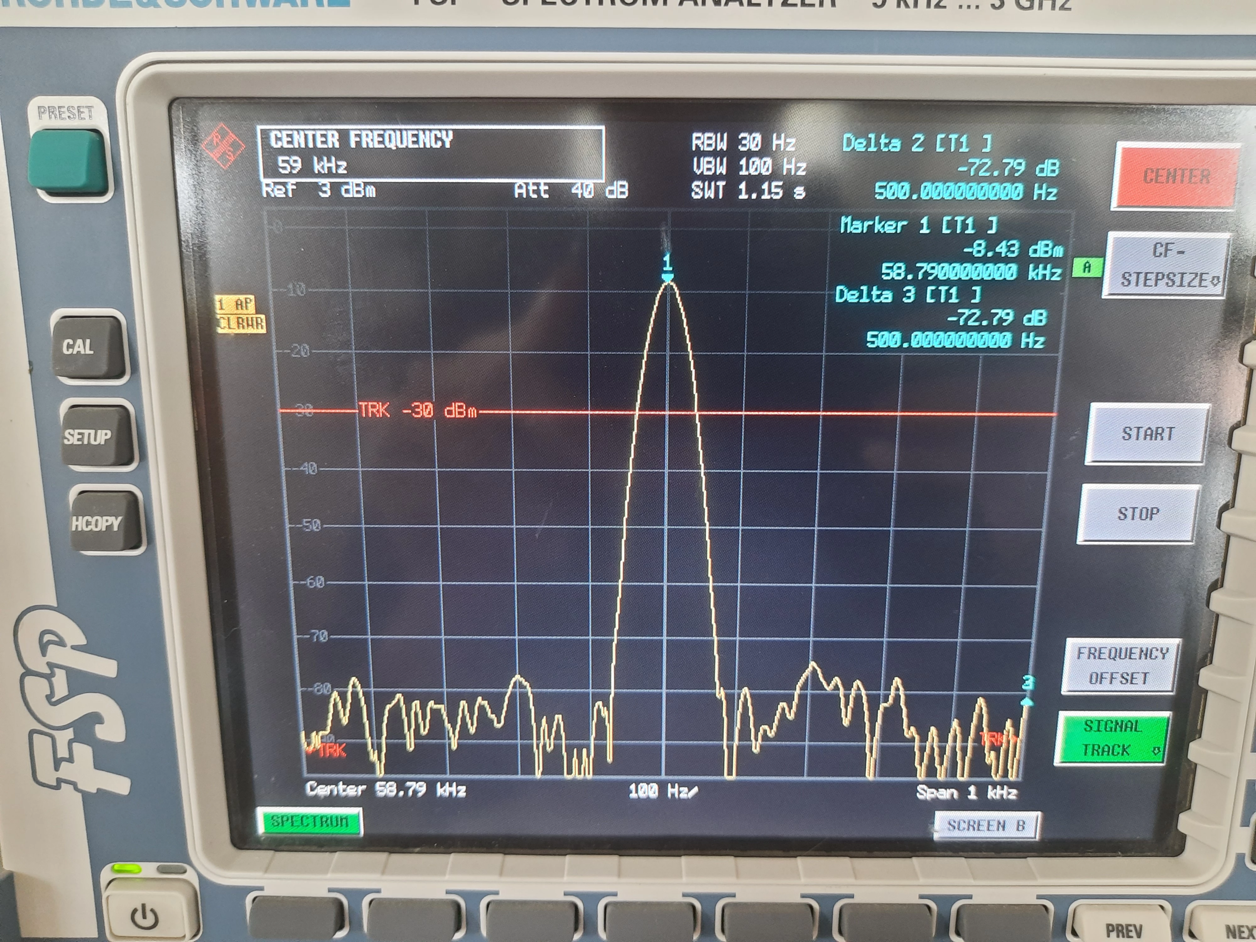

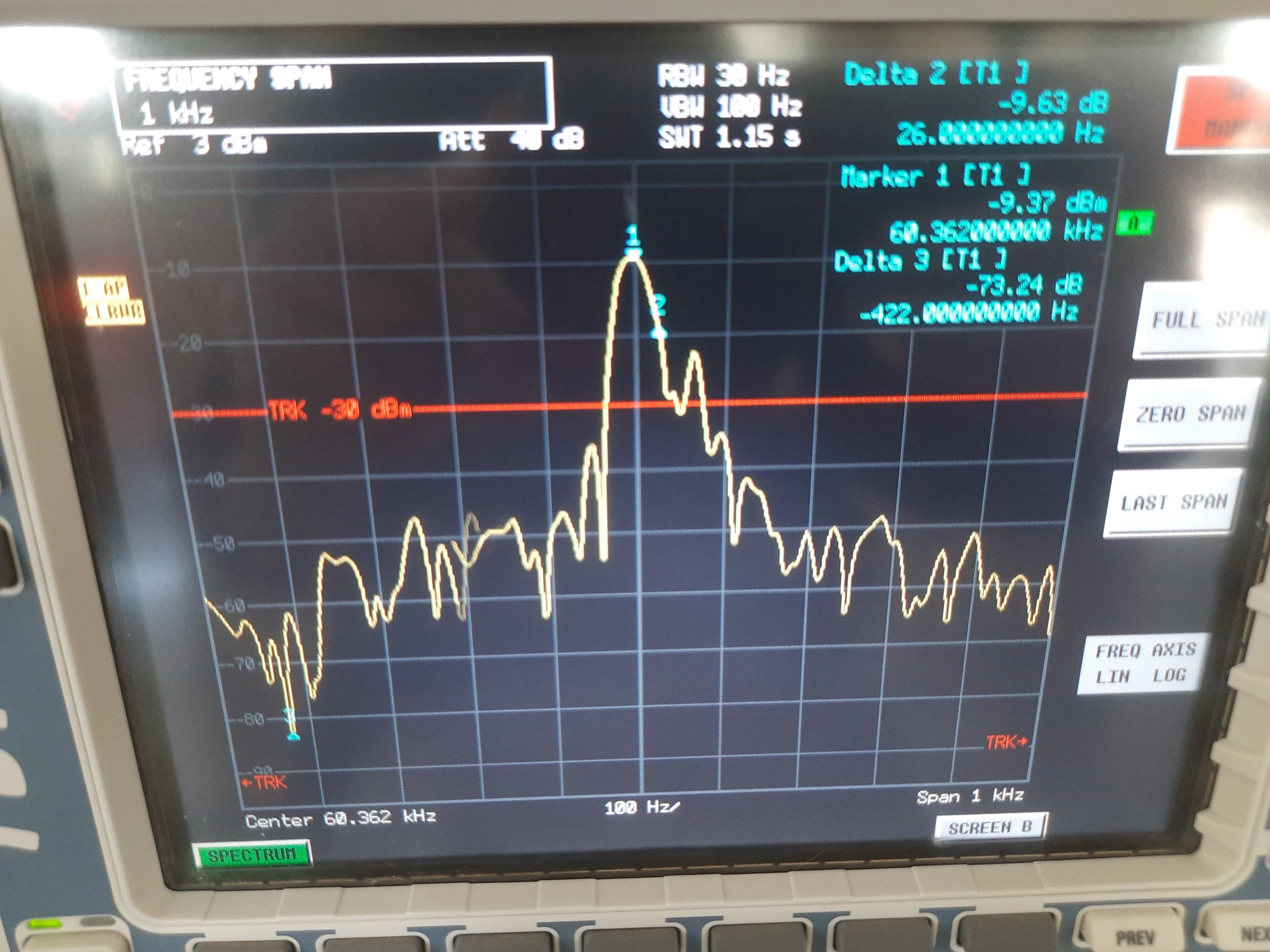

I have implemented a DDS sine wave generator where I use a timer interrupt to update DDS phase word and also use the same timer triggering a SPI transmission via DMA to an external DAC using a nucleo-g431rb. I am now doing the same thing with a nucleoh723zg on a different pcb, but cannot achieve the same performance. I've only uploaded 1 spectrum image of the H7 output but the problem is the image I uploaded is not the constant spectrum, it's center frequency changes -20 to 20 Hz every sweep.

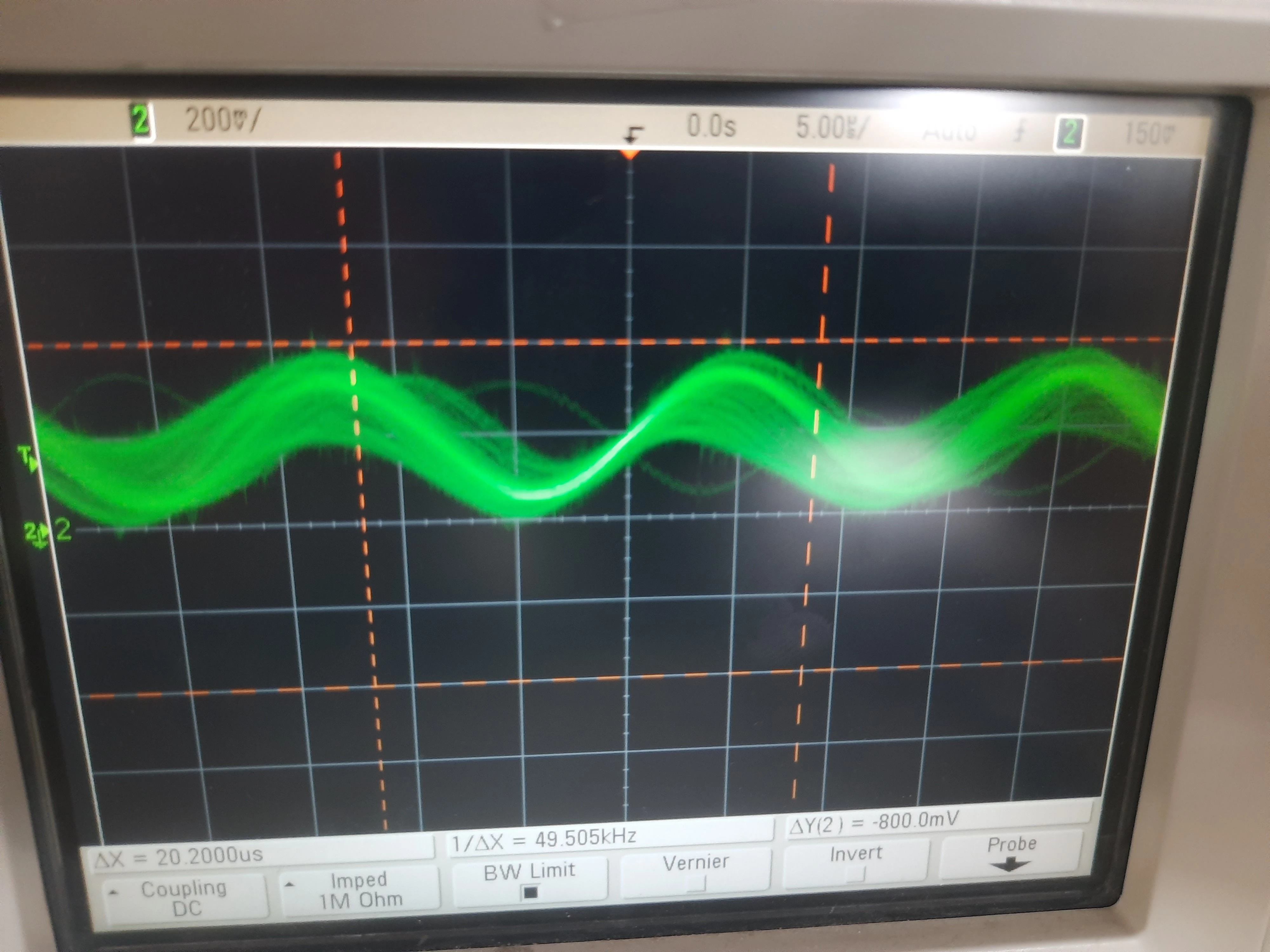

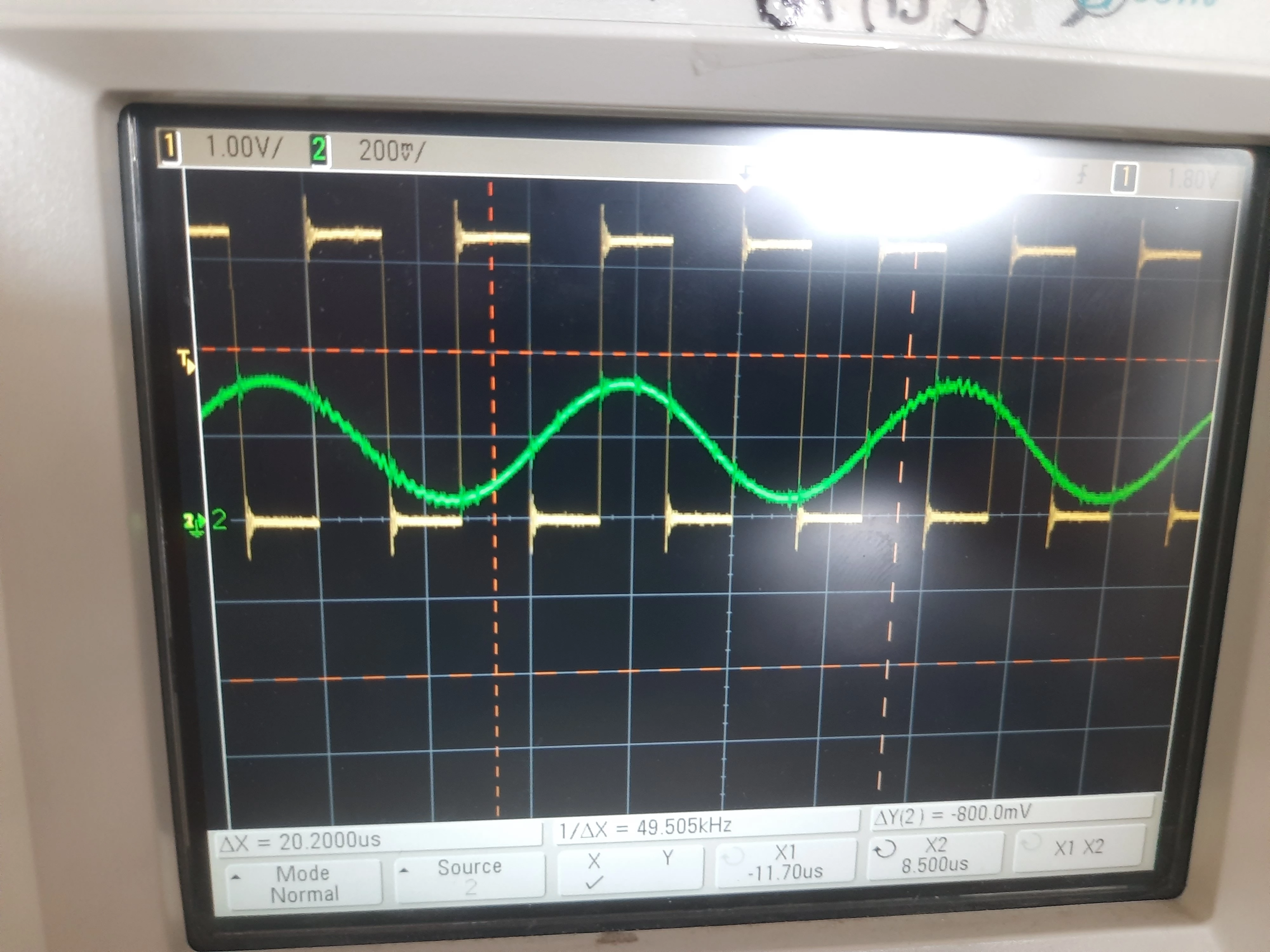

My code and DDS output spectrums and scope images are below. I am using LL functions everywhere except for some initialization stuff that are turned off shortly after.

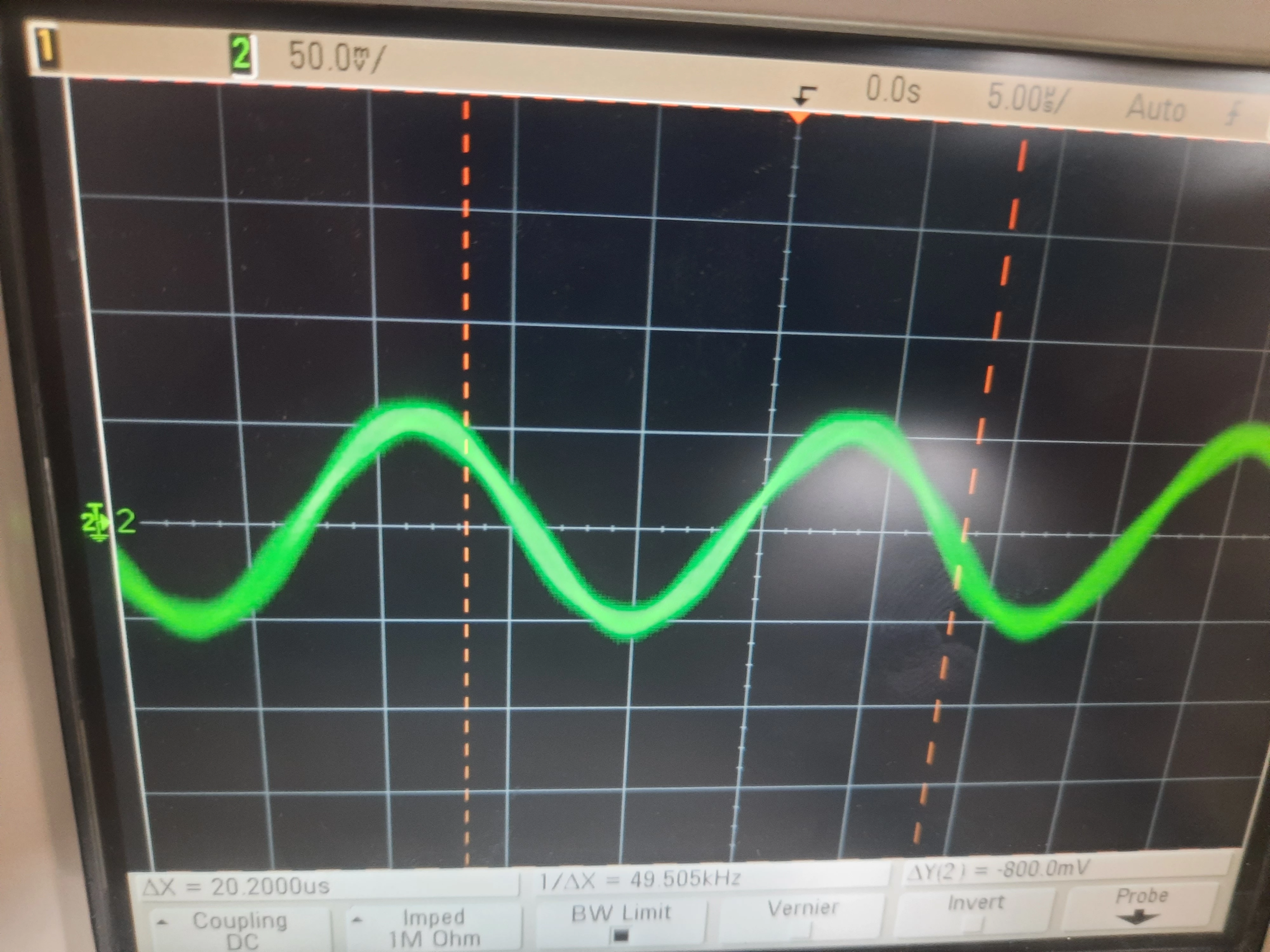

Last time I uploaded code to G4 was ~3 weeks ago, from the images I can see that there is no problem with the uploaded code or LUT in the ROM. However when I disconnect and reconnect H7, before uploading code again the signal in the scope is distorted, probably meaning some ROM corruption occurs when disconnecting or just powering up)

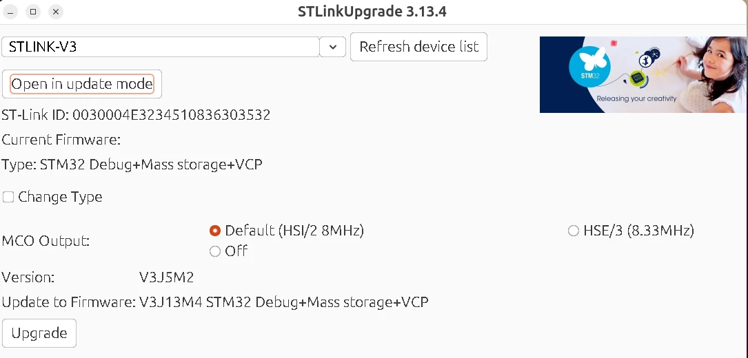

Nucleo-H7 by default getting clock from St-Link-V3  HSI, that is internal RC oscillator. Don't know about G431, but nucleo-G474re has crystall 24 MHz, and consequently clock is very clean. I'd suggest to re-program your H7 to 8.33 MHz clock from St_Link, switching to crystal instead of RC. There is programmer application and instructions on this ST.com site
Since you have access to SA, it 'd make sense to conduct some measurements before/ after you reconfigure clock base. Set GPIO pin to be driven by  timer-PWM and compare spectral width on G4 and H7.

I am sure I have no timing problems in hardware as my SPI CS signal shows no jitter in scope, and I remember I was able to get away with a little jitter when developing with G4, though I fixed it later. Also I think you would agree that the signal from the scope doesn't shout noisy spectrum at first glance, I've only noticed it when I tried to sweep a high Q resonator, spectrum analyzer is not my usual debugging tool.

I think, you 've missed the point. Clock tree starts from st-link-v3 than arrives to HSE (bypass mode) on nucleo H7. So to do it right, reprogram st-link to output 8.33 MHz, than reconfigure HSE /PLL to new source, so PLL 'd stay in allowed range <960 MHz or so. See picture, and link
My scope does show jittery clock for new board before I make updates. Rigol 200 MHz, timers or MCO has to be set above 40-50 MHz (GPIO very fast speed). Scope also has SA mode, likely all modern DSO have. Try.
