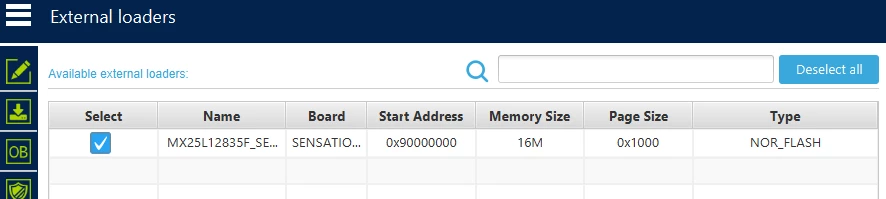

After I change the linker file with linker.ld of the branch contrib stm32-external-loader\Loader_Files\other devices and build and generate the file .stldr and put it into STM32CubeProgrammer\bin\ExternalLoader
Then when I open STM32CubeProgrammer I see my external loader in the list :

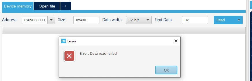

But when I try to read or erase at QSPI address 0x90000000 I get an error immediatly and nothing happens on the QSPI bus signals like if the functions are not executed :
Does anyone have an idea of what I forgot to do ?

The error in STM32Cube Programmer is the init function that fail directly:
15:03:20:870 : Read progress:
15:03:20:871 : Reading data...
15:03:20:871 : Init flashloader...
15:03:20:871 : Init function fail
15:03:20:876 : Error: Data read failed
I try to empty the Init function and only return 1 (=LOADER_OK) and have the same behavior.

@Pavel A. I wanted to use the ST external loader to have a quick solution to program the external memory and using it when degugging under STM32 Cube IDE
@Tesla DeLorean It seems that the code is not executed when using STM32 Cube Programmer, I try to simply toggle a GPIO in Init() function and it is not working I've immediatly the Init function fail error.
(I verified before that it works in debug with the standard linker file STM32H562RGTX_FLASH.ld and without changing VTOR as well as all other functions I used)
