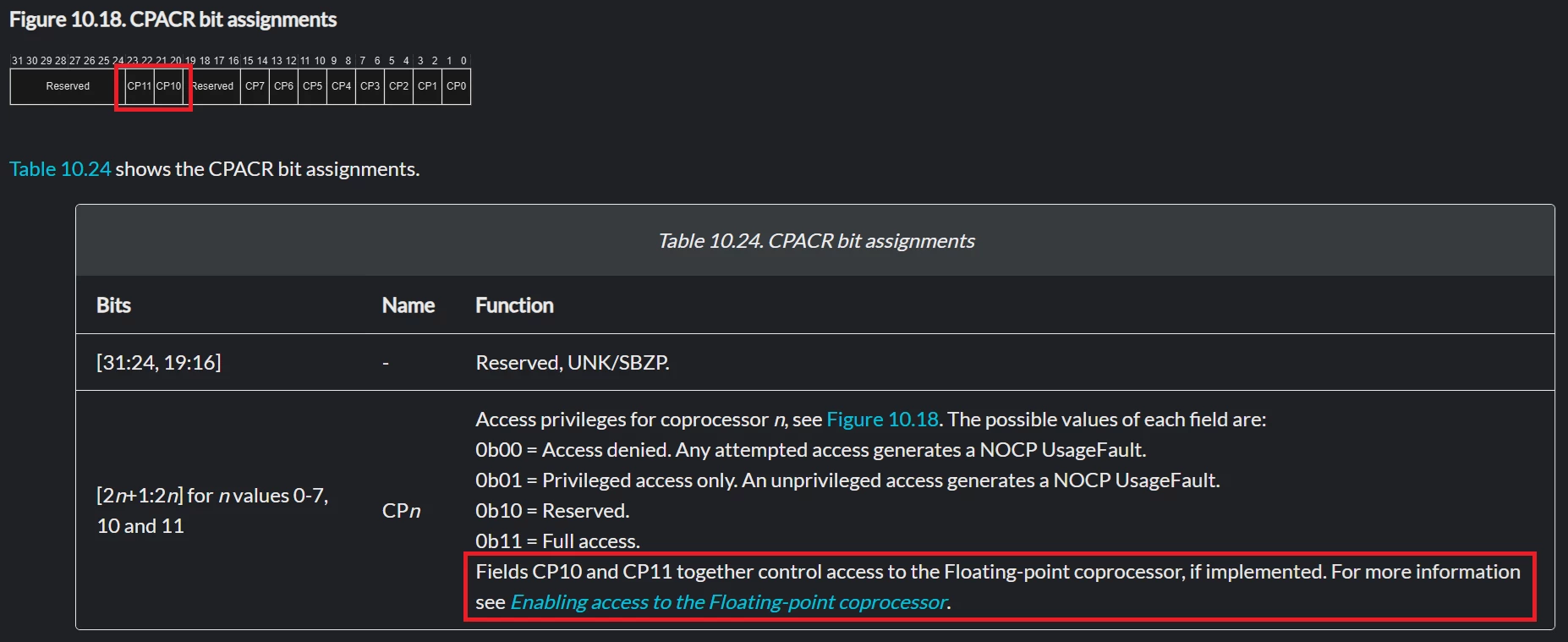

Better to ask the question to Emcarft or who developped that buildroot.
my question stays insofar as “how does anyone make ARM Cortex-M7 boot with FPU?”
You need to ensure CP10 and CP11 bits are set in SCB_CPACR register:
https://developer.arm.com/documentation/ddi0403/d/System-Level-Architecture/System-Address-Map/System-Control-Space--SCS-/Coprocessor-Access-Control-Register--CPACR
In the HAL implementation (system_stm32f7xx.c file) / almost after reset:
void SystemInit(void)
/* FPU settings ------------------------------------------------------------*/
#if (__FPU_PRESENT == 1) && (__FPU_USED == 1)
SCB->CPACR |= ((3UL << 10*2)|(3UL << 11*2)); /* set CP10 and CP11 Full Access */
#endif
Hope that helps.

darkfaderAuthor
Jul 14, 2026 1:03 PM UTC
Thank you!
I see. So if the kernel doesn’t flip those two switches the FPU will be there, but not enabled.
Then it could be true that it’s still “off” I got to try to boot with softfloat and later enable it, or look for a way to enable it when U-boot is loaded. I’ll ask emcraft next year when I can get their kit.
knowing that they also don’t enable it in-kernel it’s plausible that it is “disabled” here.
I did a quick search and it seems this will indeed be possible in U-boot.
https://stackoverflow.com/questions/22705690/how-to-set-the-socs-register-values-in-linux-kernel-and-u-boot
I take it the FPU stays on till power cycle?

darkfaderAuthor
Jul 14, 2026 7:57 PM UTC
I think I managed to turn on the FPU in U-Boot, using mw.l 0xE000ED88 0x00F00000
Still a few rounds to go, adding CONFIG_VFP (and probably some more stuff I wanted) it got stuck again at “Loading kernel”, but I already know that, it’s just the image size.
I’ll later(*) work on enabling XiP+SPI and then the size will be fine.
