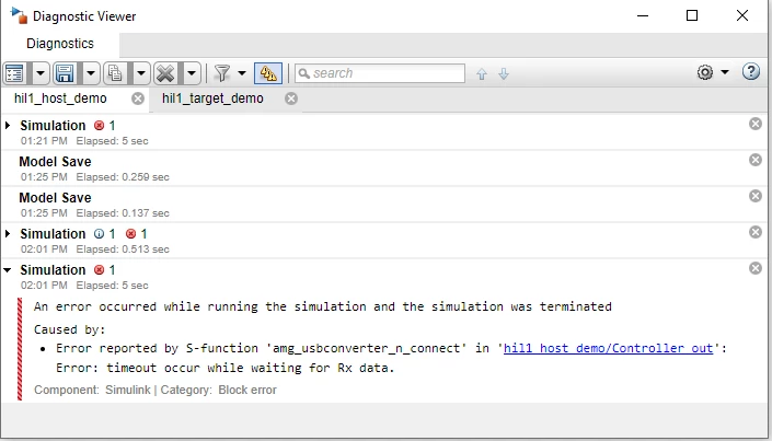

I am trying to establish a hardware-in-the-loop setup with a STM32F429I-DISC1 with Waijung blockset. But I have a problem trying to establish UART communication. I dont receive any data coming out of the microcontroller with this method.

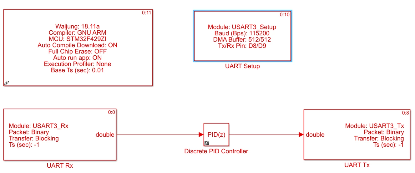

The host and the target simulink simulations are given in the figure below. I have installed the waijung_18.11a blockset.

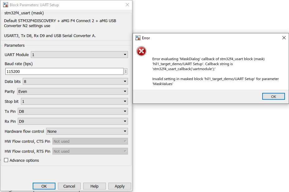

0693W00000GWb06QAD.png0693W00000GWb0fQAD.pngFirstly, I wanted to try setup the UART Setup-block with certain settings, but stumbled on the following: I can't set it to UART1 and get the following error given in the figure below. The options to set the Tx pin and the Rx pin are also limited.
0693W00000GWb7MQAT.pngSo I tried to establish the communication with USART3, PD8 and PD9 by first building the target and running the host. And got the following error given in the figure below. According to the datasheet this pins can be used for UART: https://www.st.com/resource/en/datasheet/dm00071990.pdf .

Just ignore the error in the 3rd picture. Then, double-click the UART setup block again to open it. Don't change anything and close it. Then open it another time, and the UART module has been set to your desired number. The Tx and the Rx pin will also change according to the selected UART module.
If you make changes in these simulink blocks of Waijung blockset, you need to reopen it, to see the changes. In this case, it was more than once. Kinda weird.

For USART1 to VCP to PA9/PA10 check SB11 and SB15 bridges
PD8 and PD9 are connected to the SDRAM
What's the UART Module# ?

How do I exactly configure the UART Setup block with Waijung blockset with these solder bridges. At the moment I can only select for Tx pin the following: "Not used", "B10", "C10" and "D8". For Rx: "Not used", "B11", "C11" and "D9".
Is there maybe some way to connect the PD8 and PD9 to the UART-pheripheral?
During the simulations given in the figures above I used UART Module 3
