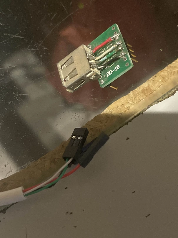

I have a laser engraver that runs on an ESP32 S2 Mini microcontroller. It has the following signature: “Espressif CDC Device” and emulates a COM-type serial port. I had two identical cables; if I connect my engraver to my PC via a serial program (NinjaTerm), I can control GRBL. I cut one of these cables, and they have four wires: VBUS, D+, D-, and GND. After crimping some connectors onto the ends of the wires and testing the cable connected to the port to distinguish between my D+ and D-,
Now I’d like to put an STM32F411 (WeAct BlackPill v3.0) between my engraver and my PC to control my homemade Z-axis. The PC side is on a UART port of the STM32 connected to a CH340, and on the engraver side, a USB (D+/D-) CDC Host (Note: I’m not using the USB-C connector already soldered onto the BlackPill). The UART programming side worked perfectly. Where it’s getting stuck is on the CDC side… no response…

Andrew Neil
June 10, 2026
As ​@Gyessine said, the Black Pill is not an ST Product, and might not have a genuine STM32.
Therefore it would be best to first get this working on a genuine ST board:
https://www.st.com/en/microcontrollers-microprocessors/stm32f411ce.html#tools-software
Once you’ve got it working on a genuine ST board, you could then move on to the Black Pill
Note that connecting to USB via flying leads is not going to give great results;  you’d be better using a board with a dedicated USB host socket - looks like the 32F411EDISCOVERY is the best bet for that ...

So, the CH340 and UART part is working fine, and the problem is the USB CDC host function, correct?
Does your board provide power to the connected USB device or is it self-powered?  Does the device detect and start enumerating - or no response at all, to any host request?

Thank you for your reply. When I chose my microcontroller last year for my LCD project, I selected it for its high clock speed. So I bought a BlackPill for development and five STM32F411CEU6 chips. I prototype everything on a breadboard and always manufacture my own final PCBs. So I used one for the LCD screen project, and the other was a relay controller with serial control. I had three left over. I’ll probably try soldering one onto a picnic table for a breadboard. I have nothing against an official development board. As far as I’m concerned, a NUCLEO-F411RE with its STM32F411RET6 chip could do the trick… but first I’d like to analyze two schematics to determine the bare minimum requirements for the MCU. I already have an Altium version of the other MCU.
Breadboards aren’t great for high-speed digital circuits - such as USB.
You will be far better off using a dev board with known-good USB hardware.
It does not have any hardware for the microcontroller’s USB.
As previously noted, the 32F411EDISCOVERY would be far more appropriate ...

I also modified my USBH_UserProcess to include UART outputs. Here are the IDs detected...
#define HOST_USER_CONNECTION                    0x04U
#define HOST_USER_DISCONNECTION 0x05U
#define HOST_USER_UNRECOVERED_ERROR 0x06U
but never HOST_USER_CLASS_ACTIVE... it’s as if I have a HOST but no CDC connection... I have two things to try.
1. I need to put my connector back on and not use my modified cable. With the connector, I can connect my shield case to ground.
2. I also have a BluePill... I should program it as a USB CDC device. Maybe it’s the CDC on my ESP32 that’s acting up.

Thanks to everyone for every pointed direction. I finally succeeded after figuring out a few mistakes. First, at the beginning, I only had my engraver as a device to test my host. Application_Ready started triggering ON after I decided to create my own device using a BluePill. Next, I had assumed that my USB_OTG_FS_VBUS (PA9) would power my VBUS. But in reality, PA9 and VBUS must be powered by a 5-volt source.

After that, I was back to square one with my laser engraver. Application_Ready still wasn’t triggering. After modifying USBH_CDC_InterfaceInit

I discovered that Creality was using protocol 0x00 instead of 0x01. So I modified usbh_cdc.h
#define COMMON_AT_COMMAND                                       0x00U
Now this method is compatible with the Nucleo-STM32F411RE, and pins PA11 and PA12 are populated. I’m even thinking of modifying my breadboard and making the Nucleo the central processor with a custom 40-pin female header board @ DIP 40.
