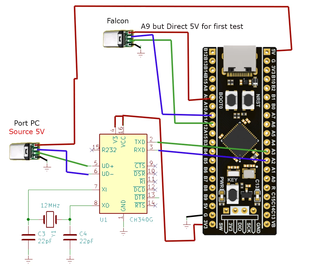

I have a laser engraver that runs on an ESP32 S2 Mini microcontroller. It has the following signature: “Espressif CDC Device” and emulates a COM-type serial port. I had two identical cables; if I connect my engraver to my PC via a serial program (NinjaTerm), I can control GRBL. I cut one of these cables, and they have four wires: VBUS, D+, D-, and GND. After crimping some connectors onto the ends of the wires and testing the cable connected to the port to distinguish between my D+ and D-,
Now I’d like to put an STM32F411 (WeAct BlackPill v3.0) between my engraver and my PC to control my homemade Z-axis. The PC side is on a UART port of the STM32 connected to a CH340, and on the engraver side, a USB (D+/D-) CDC Host (Note: I’m not using the USB-C connector already soldered onto the BlackPill). The UART programming side worked perfectly. Where it’s getting stuck is on the CDC side… no response…

So, the CH340 and UART part is working fine, and the problem is the USB CDC host function, correct?
Does your board provide power to the connected USB device or is it self-powered?  Does the device detect and start enumerating - or no response at all, to any host request?

FleuveAuthor
Jun 11, 2026 4:54 AM UTC
​@Ozone  ​@Pavel A.
Yeah Uart part working great with NinjaTerm.

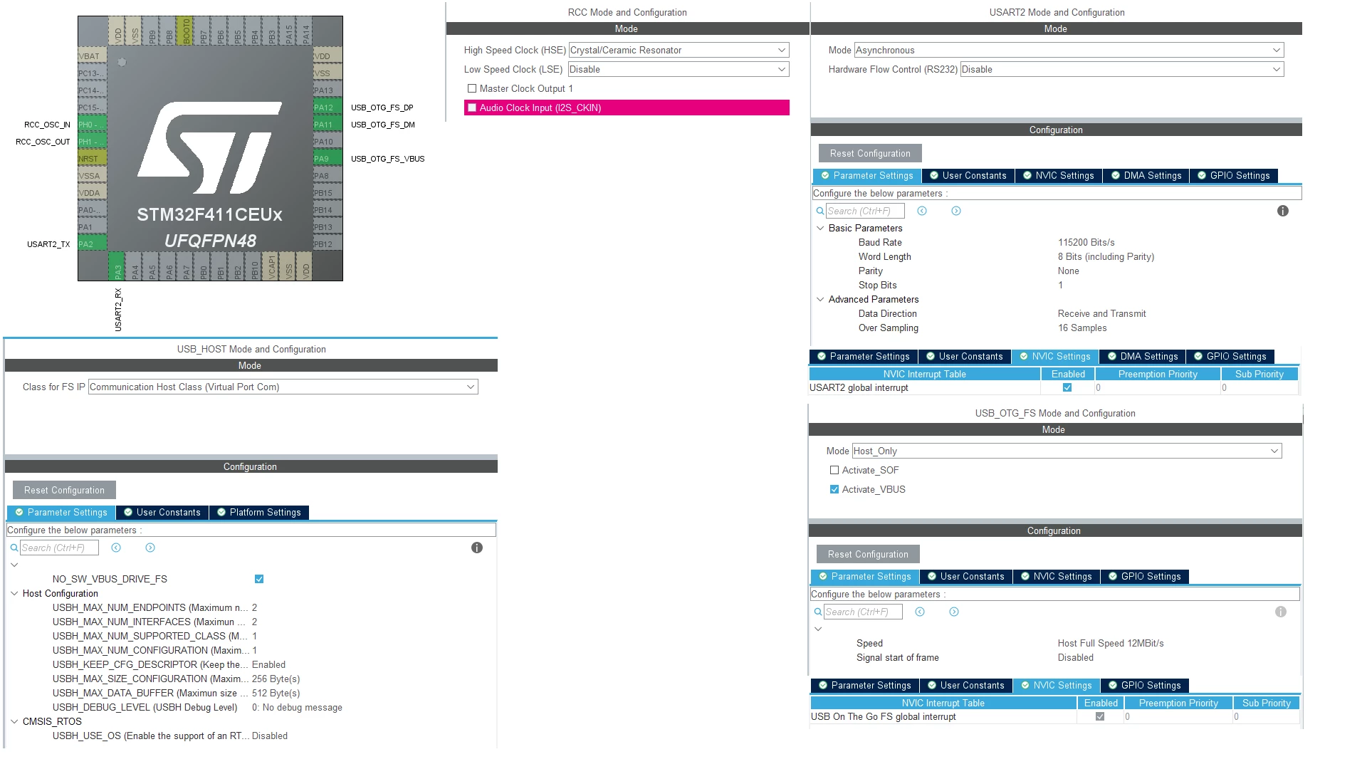

I've had time to run a few tests... the code currently generated by CubeMX seems to be doing something. I stepped through it in the debugger, and it passes MX_USB_HOST_Init.
if (USBH_Init(&hUsbHostFS, USBH_UserProcess, HOST_FS) != USBH_OK)
Error_Handler();
if (USBH_RegisterClass(&hUsbHostFS, USBH_CDC_CLASS) != USBH_OK)
Error_Handler();
if (USBH_Start(&hUsbHostFS) != USBH_OK)
Error_Handler();
No Error!!
I also modified my USBH_UserProcess to include UART outputs. Here are the IDs detected...
#define HOST_USER_CONNECTION                    0x04U
#define HOST_USER_DISCONNECTION 0x05U
#define HOST_USER_UNRECOVERED_ERROR 0x06U
but never HOST_USER_CLASS_ACTIVE... it’s as if I have a HOST but no CDC connection... I have two things to try.
1. I need to put my connector back on and not use my modified cable. With the connector, I can connect my shield case to ground.
2. I also have a BluePill... I should program it as a USB CDC device. Maybe it’s the CDC on my ESP32 that’s acting up.
