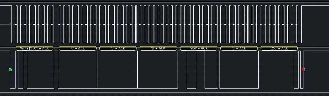

STM32f207 I2C to m24LR64 eeprom
Posted on August 29, 2012 at 14:20
Hi

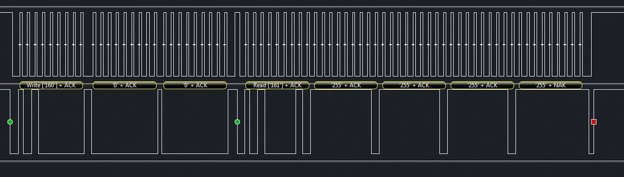

I'm trying to write and read data to a m24LR64 eeprom using I2C on STM32f207
I can read data from the eeprom, but when i try to write data to the eeprom, it always writes 0xff og the memory address i'm trying to write.
this is my I2C config:

I'm using the STM32_i2c_ee.c function to read and write
status = I2C_EE_PageWrite((
uint8_t
*)data,0x0000,0x04);
I2C_EE_BufferRead((
uint8_t
*) dataRead,0x0000,0x04)

See attached files for pin output
