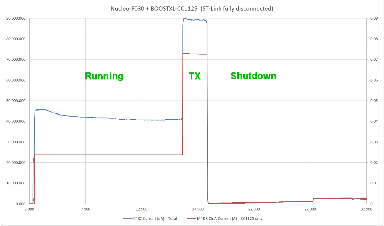

I have a custom board with STM32F030 controlling a TI CC1125 sub-GHz radio transceiver via SPI plus a few GPIOs.
Everything is fine for normal operation (TX, RX, etc), but the system has a "Shutdown" mode where the CC1125 is put into its low-power SLEEP state, and the STM32 is in STANDBY.
In SLEEP the CC1125 should take under 1uA but, after sending the SLEEP command, I see the current rise over ~4s and eventually settle at ~2mA.
I have managed to reproduce this using a Nucleo-F030R8 (ST-Link removed) and a TI dev board:
The blue line is the total system current (STM32 + cc1125); red line is just the CC1125.

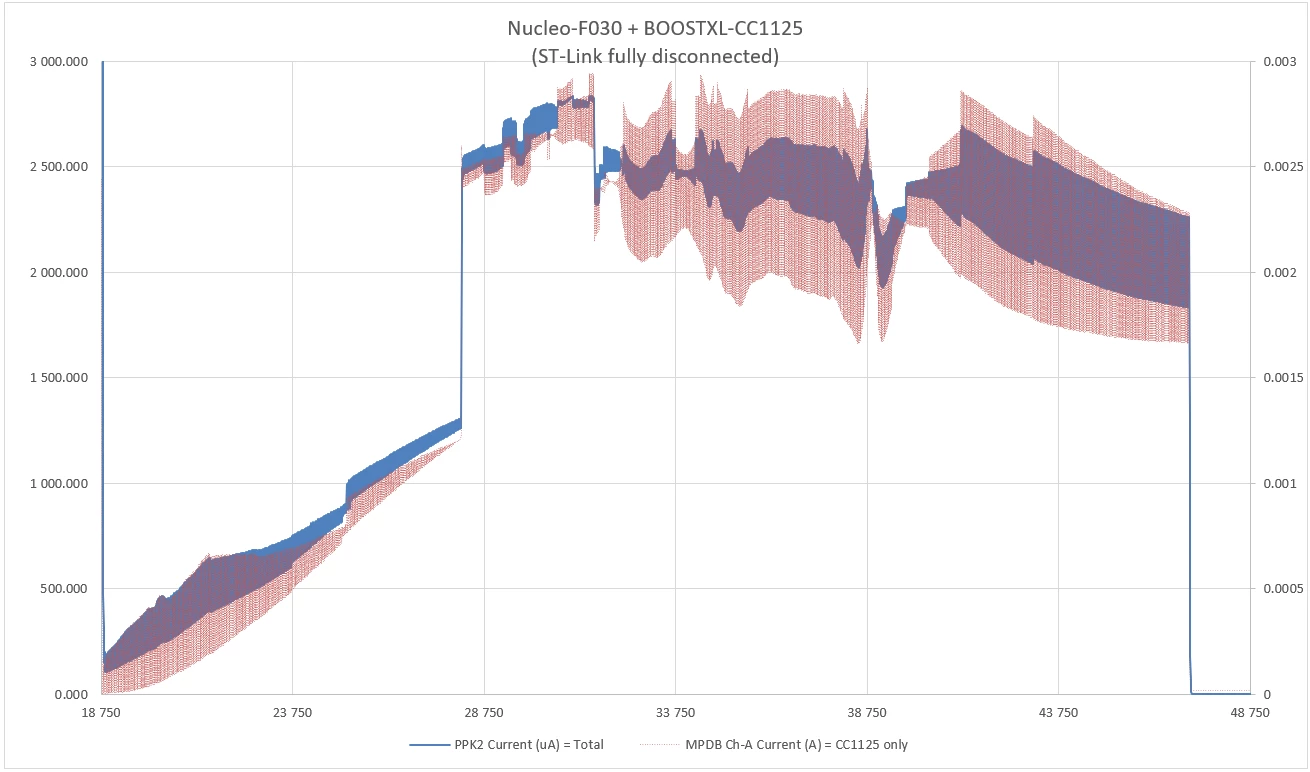

Zooming-in on the Shutdown part:
There seems to be something charging-up and then (partially?) switching-on?
With the CC1125 disconnected, the Nucleo alone takes a steady ~3.1uA with the STM32 in STANDBY.
So it looks like the issue is with the CC1125 somewhere; just posting here in case anyone has any suggestions.

waclawek.jan
waclawek.janBest answer
May 12, 2026 3:59 PM UTC
Just a blind shot: some floating pin?
6 replies
waclawek.jan
Andrew Neil
May 12, 2026 4:07 PM UTC
I don't think so - I think I've been through all the options!
waclawek.jan
May 12, 2026 4:32 PM UTC
Physically measuring them?
Like poking around with an oscilloscope probe during those 4 seconds, or maybe even beyond them?
Andrew Neil
May 12, 2026 4:38 PM UTC
Now I've got it reproduced on devboards with accessible pins, that's the next step...
waclawek.jan
May 12, 2026 5:46 PM UTC
oh, but that chip is QFN, the "pins" are basically accesible;  so that's just a sharp pin at the end of the probe, a steady hand, and possibly a good loupe... :):)
aren't most of the signals accessible at the surrounding resistors/capacitors anyway?
[EDIT]
also, is the chip completely "dumb" in the sleep/"high-current shutdown", or could it be queried through SPI from the STM32? I mean, not according to the manual, but try experimentally...
