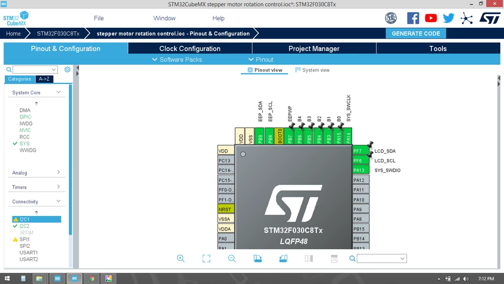

STM32F03 I2C1 not working?
i want to store data in to I2C EEPROM AT24C02 so in MCU I2C1 is used but i saw in oscilloscope I2C1 both pins are remains low
I2C2 works fine with i2c LCD.
i placed pull up resistor 10k both line CLK & SDA in EEPROM.
EEPROM address 0xA0
how to solve it?

3 replies
Dec 29, 2021 2:27 PM UTC
You don't show your usage of these functions anywhere. Include the entire code if possible.
Your I2C2 initialization is missing a setting to GPIO_InitStruct.Alternate.
The very first thing you should do to debug I2C is to see if HAL_I2C_IsDeviceReady returns HAL_OK. If not, there is a connectivity issue.
If SDA/SCL are both low despite the presence of external pullups, it suggests the pins are not initialized correctly, or there is an issue with your measurement, or there is some other hardware issue.
parth kothiya
Dec 29, 2021 10:42 PM UTC
My problem with I2C1 EEPROM not working in I2C1 I'm using alternate pins and in cods line number 132 alternate function it's configured.
