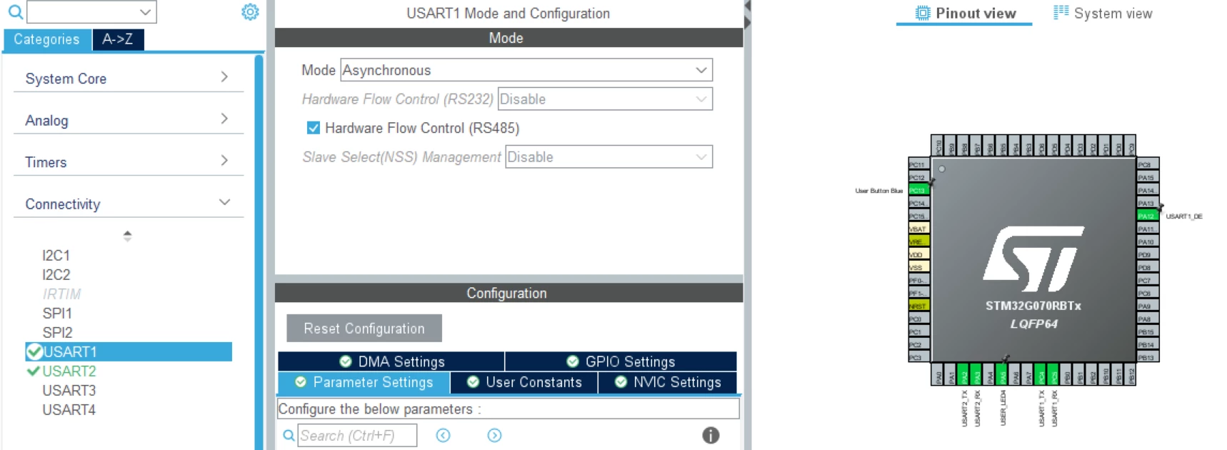

STM32 Nucleo-64 G070RB Board USART1 Modbus RTU Master without RTOS and UART Interrupts
I am trying to configure STM32 Nucleo-64 G070RB Board as Modbus RTU Master to send commands to a slave and receive response. I have connected MAX485 - TTL to RS485 board. Powered with 5V, DE and RE connected to USART1 DE Pin. Board's A and B are connected to slave (VFD) at a distance of less than 2 meters.

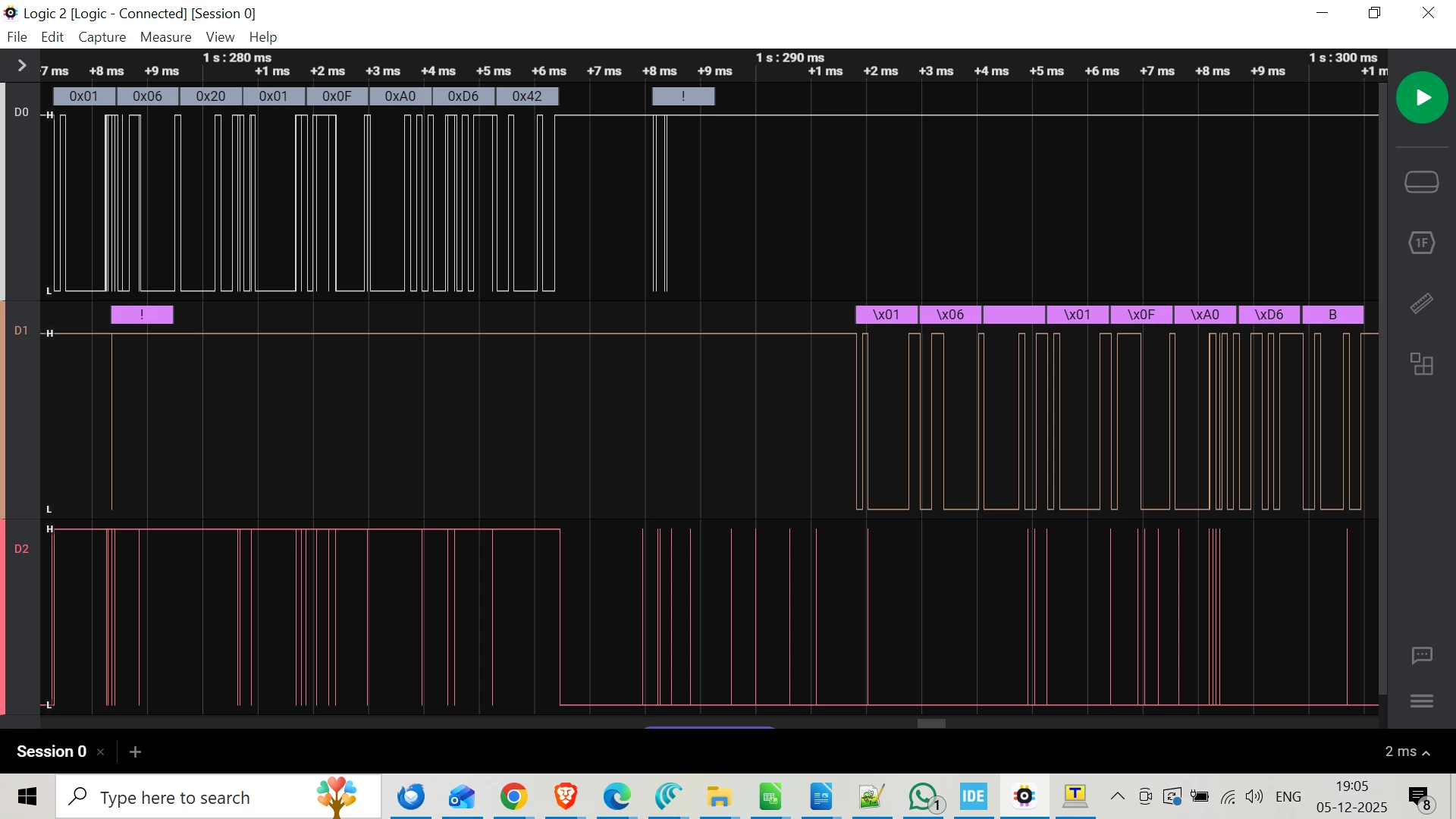

arunachalamramBest answer
Dec 5, 2025 1:59 PM UTC
It works fine now. D0 is data sent by STM32 (Modbus RTU Master) and D1 is reply data from VFD and D2 is DE. Rewired and cleaned by merging with previous working code. Issue was probably with
1. Wiring of Rx signal from STM32 to MAX485 (TTL to RS485 board) and / or to VFD.
2. Delay
Updated code to send and Modbus RTU frame is:
tx_status = HAL_UART_Transmit(huart, request, 8, 100);
while (__HAL_UART_GET_FLAG(huart, UART_FLAG_TC) == RESET);
rx_status = HAL_UART_Receive(huart, response, 8, 200);
Thank you all for the inputs. Issue can be closed.

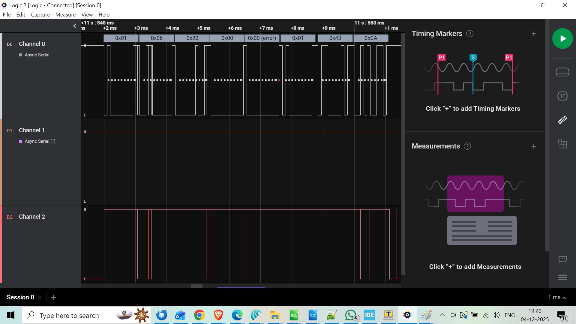

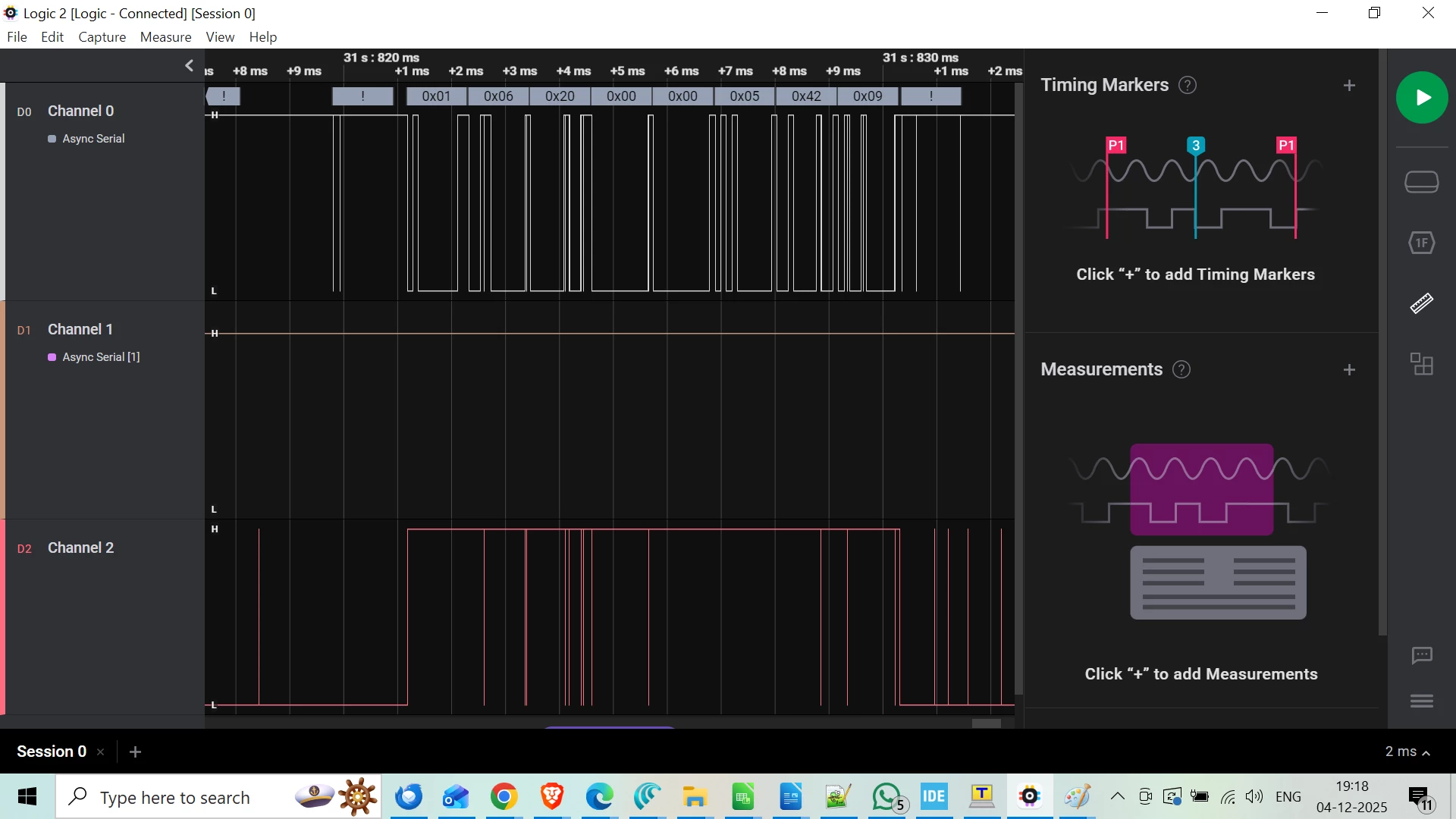

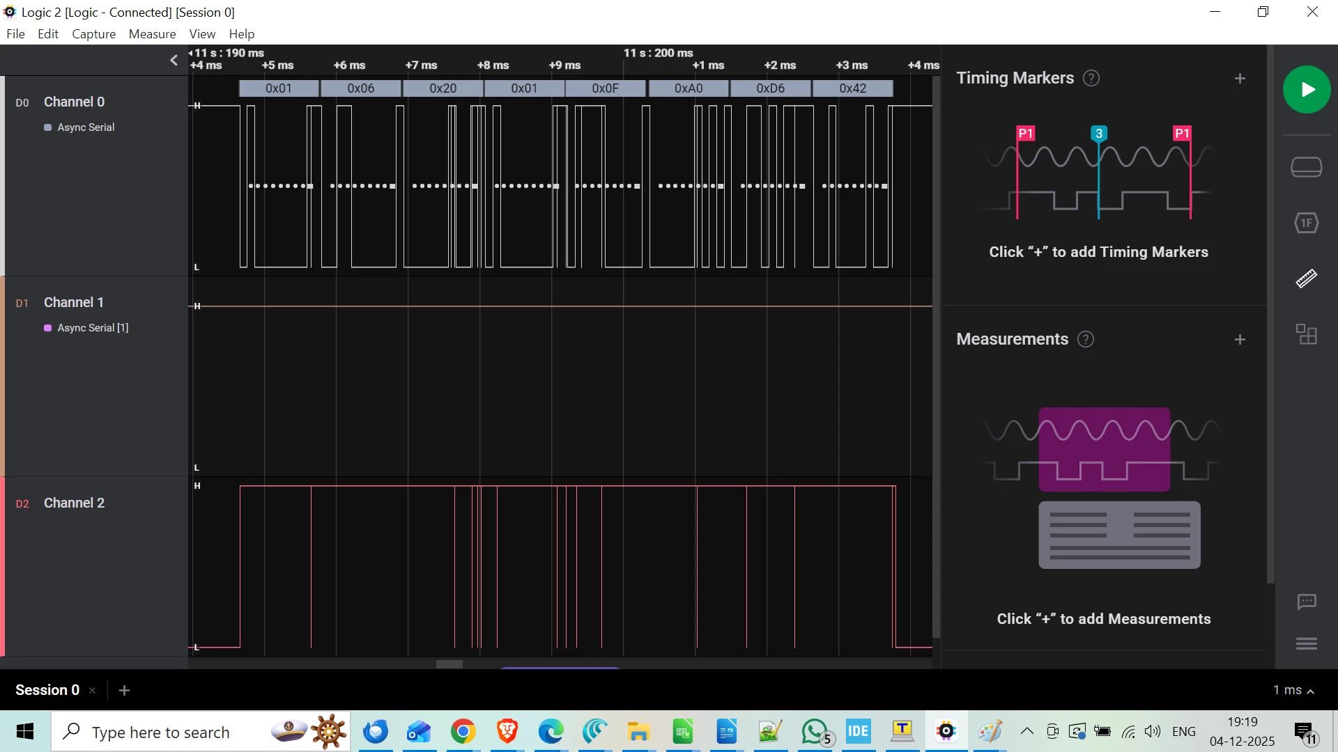

Dec 4, 2025 2:08 PM UTC
These are captured with Logic Analyzer:
Channel 0: Tx from MCU (bytes are good)
Channel 1: Rx from VFD (No signal at all and hence there is no image for this)
Channel 2: DE (PA12) from MCU (SET during MCU UART transmitting and then RESET)
Somehow VFD does not work now - perhaps I lost / rearranged some lines of code or delay. Need to look at backup code, merge and test.
These are only to show DE (PA12) toggled by hardware (SET during transmit) so that half-duplex mode shall be effective with MAX485. Shall keep you posted after getting code to previous state / condition  (i.e., VFD working).

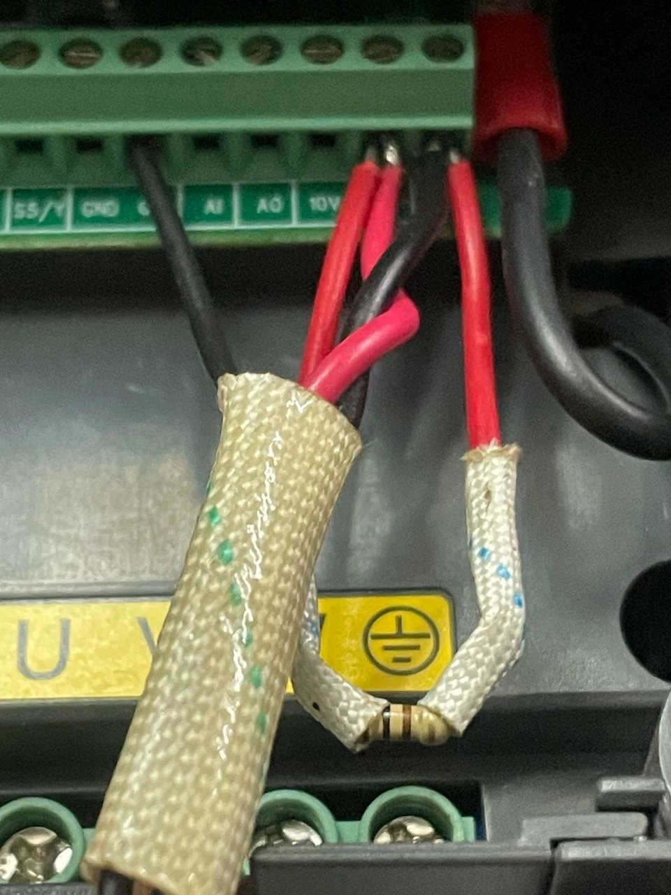

There is 120 Ohm resistor on MAX485 - TTL to RS485 board and I connected 100 Ohm resistor at VFD end.
