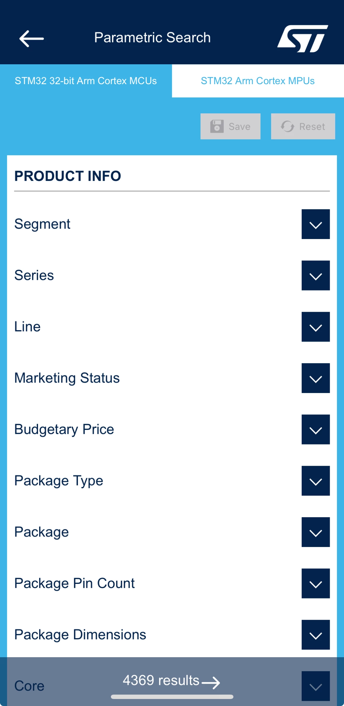

EasyNet
EasyNetAuthor
Dec 12, 2025 2:52 PM UTC
Hi @Issamos ,
Is similar with STM web model. Doesn't shows how many FMC controllers and how may LTDC controllers they have.
Thanks.
Issamos
Dec 12, 2025 2:57 PM UTC
You can use the Parametric search to select how many FMC, LTDC or any other peripheral you are looking for:
Best Regards.
II
