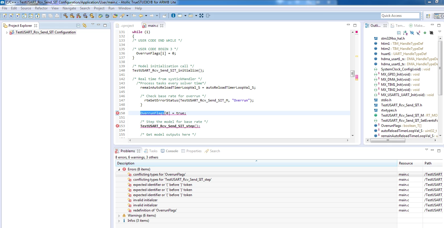

Hi all,
I am trying to generate a working C code using the Matlab/Simulink package STM32-MAT provided by ST. I am using Matlab R2014a v8.3 on Windows 7 I am using TrueSTUDIO v5.3.0 as toolchain I am using the STM3CubeMx v4.7.0, with the Firmware Package Name and version ''STM32Cube FW_F4 V1.5.0 I built the model called TestUSART_Rcv_Send_SIT in ''normal'' mode (No PIL) in the folder STM32demos/USART. It opens the associated.ioc file and in the Project Settings I selected the Toolchain / IDE TrueSTUDIO. I generated the code, opened the TrueSTUDIO project, and tried to build it. However, I have a plethora of compilation errors as illustrated on the enclosed screenshot In addition, when I looked at the main.c file generated by the Cube, the code seems obsolete with lines like while(1) loop from the copy paste code above. And I don't know why.

The building process from Matlab provides a report where the C codes are generated. I copied the code inside the ''USER CODE 3'' of the main.c generated by Matlab and replace it in the main.c generated by the Cube. Now the compilation is fine, but it doesn't seem that this main.c has a real meaning or has something to do with the functionality described in the Simulink Model; in that case ''Wait for 10 char on USART Rx and send char back to USART Tx'' . The same problem occurs for the models entitled SimpleGPIO.slx in STM32demos/GPIO and the generated main function is nearly the same. Do you have any ideas about Why Do I have this issue and how can i resolve it? Thanks for your help #stm32-mat/target-matlab-stm32f4

Please upgrade STM32CubeMx. It should solve problem.
