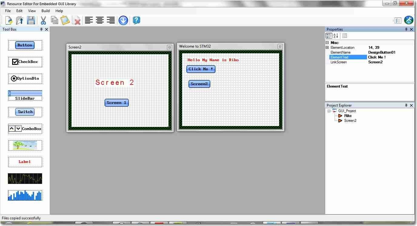

Do you know how to connect from Embedded UI Resource Editor and Keil in developing code for STM32 ?
I have used
Embedded UI Resource Editor from ST, but how can I connect it with my code in Keil ?
How can I make like this one :

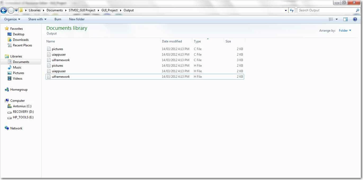

How to integrate this files (output from Embedded UI Resourse Editor ) into Keil, see pictures below :

I understand with your answer, but which files should I use to include  into and which files are being included, I saw hundred of files in ''uCOSII2.91+UCGUI3.90A'' and some files ''output'' of Embedded Resource UI editor....
Or if you have an example, how can I include the output file into a main project ?
for example, I have a very simple project
only :
main()
I include only like this :
#include --->output files from Embedded Resource UI editor
main()
   (which function should I call from the ''output file'')

I use these :
The code :
http://www.st.com/internet/com/SOFTWARE_RESOURCES/SW_COMPONENT/FIRMWARE/stm32_gui_lib.zip
The link :
http://www.st.com/stonline/stappl/resourceSelector/app?page=resourceSelectorPage&doctype=FIRMWARE&ClassID=1734
I read this one from :
Embedded GUI resource editor application AN3128
In the resource editor GUI, the user can set the output path of the files. When the output is
generated, it is dumped in the specified folders.
For the first time the user needs to change the main.c of his project.
The files are formatted and commented to enable the Doxygen tool to generate
documentation for the files. To work with the output files generated by the GUI, the
developer must make a few changes:
? The user must include all three header files in the main.c file
? The user must call Show_HomeScreen() after all the initialization has taken place on
the hardware
? The user needs to compile the updated source code and burn it on the firmware.
I do like this  in main.c :
 /* Infinite main loop ------------------------------------------------------*/
  while (1)
    Show_HomeScreen();        //show my UI form
#if defined(USE_STM3210C_EVAL) || defined(USE_STM32100E_EVAL)
    /* Catching touch events */
    if ( calibration_done )
      ProcessInputData();
#else
    ProcessInputData();
#endif
There's no problem when I compile it, but I'm not sure if I'm doing the right thing or not
Can I upload the *.hex file directly to the board using JLink ?
