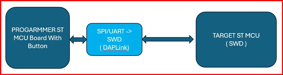

Hello Friends,
Thanks for Sugegstions , However all Seems from USB Only and Needs USB Host. Like PC / Rpi.
Thinking kind of UART / SPI interface to Programmer ( SWD based Only ).
I am sure some has Needed / Done some kind of workaround this.
Hoiwever , Found this link : https://github.com/ataradov/embedded-swd
Says Possiblity , that i am thinking About.

bsutharAuthor
Mar 31, 2026 11:31 AM UTC
 @Andrew Neil ,
"So why not use a UART or SPI bootloader?"
if u are talking about system bootloader , In that case I have to exexute BooT0 pin & RST pin High low Seqence mechanisum , Manually. Not directly , plug n Play. Also, System bootloader access not available after RDP1.
For , "Again, look at DAPLink: that will show you how to have one microcontroller program another."
Are you talking about Following Scenario ? Just confirming if we r on same page.
Andrew Neil
Mar 31, 2026 11:41 AM UTC
You could include that in what your "programmer" device does.
Or you can call the System bootloader from your application: How to jump to system bootloader from application code on STM32 microcontrollers
Or you could use a Custom bootloader which doesn't rely on BOOT0 or NRST.
Not really sure what you're saying there?
My point is that DAPLink includes code to enable one microcontroller to drive the SWD lines to program another microcontroller - so that's the part you need to extract.
(You will, of course, also need some way to get the code from your development system into your programmer)
