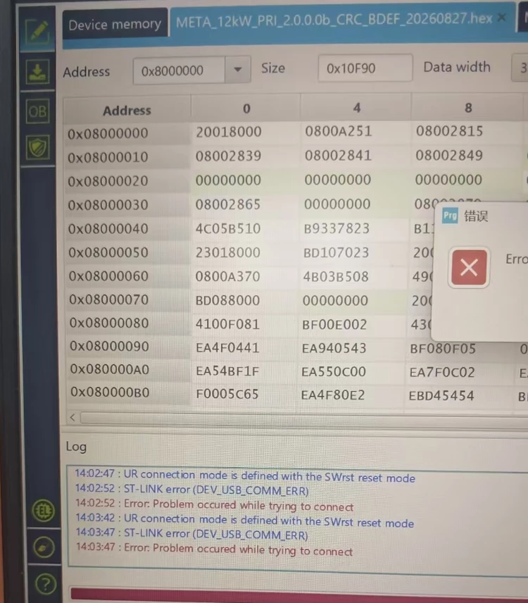

ST-LINK/V2 error problem occured while trying to conenct
Using a new ST-LINK/V2,it always Error: Problem occured  while trying to connect
I use the wire I bought before to connect it, it will be OK
I want to know why this is

Hello ​@Molly1
Check or replace the USB cable. Check connections on the board.
Then, update the ST-LINK firmware.
Use "Connect mode: Under Reset".
Which device used ?
Do you have a JTAG connection or SWD?
