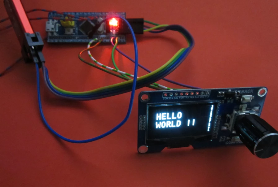

I had a SSD1306 oled ...found it and tried, on F103 board , blue Pill.
test with the instructions you used;

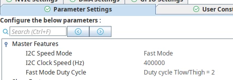

and set fast mode...is there:
OLED init : 30 ms
OLED start : 30 ms  - write hello world
So example from controllerstech working fine, just some strange pixels on right border...
....aaa, found it : oled wants some time to init, then can program/use; put a waiting time at start !

Thank you so much for taking the time to do this!
I found a different solution yesterday (increasing the timeout on the `HAL_I2C_Master_Transmit` function calls), though your solution is definitely more practical as it only introduces a delay at the start rather than letting every I2C transfer take longer to timeout.
