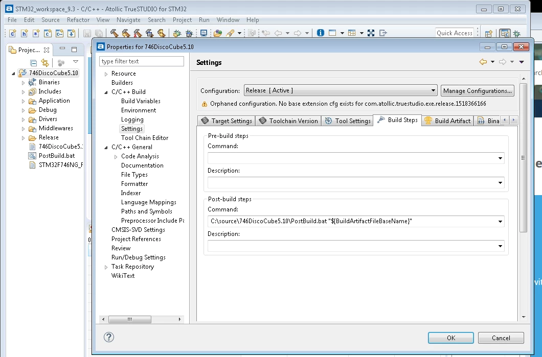

I had a problem with no elf file for a release build and I used the following:
​This was gleamed from a touchGFX project that a ST employee posted.
Create a bat file with...
arm-atollic-eabi-objcopy --remove-section=ExtFlashSection %1.elf intflash.elf
arm-atollic-eabi-objcopy -O binary intflash.elf intflash.bin
arm-atollic-eabi-objcopy -O binary --only-section=ExtFlashSection %1.elf extflash.bin
Then add the bat file to your build configuration (release)
Add the directory/file name of the hex file  to the command line. Then when you build the release, the elf file is created.
It will create the intflash and extflash elf file for programming.
If you don't need the extflash section then you can ignore it.
Good luck

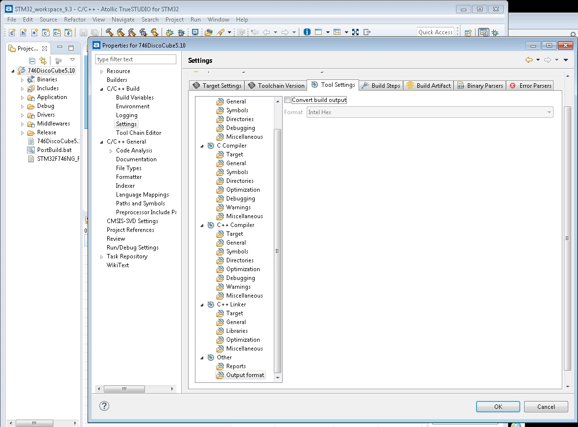

MEder
Mar 3, 2019 5:45 PM UTC
If you get a s record then maybe Convert is checked in the Output Format section?
Anyway PostBuild settings are in C/C++ Build->Settings, Build Steps Tab.
My bat file is in the project directory. Your directory names will be different.
There's somewhat of a learning curve to use these tools.
