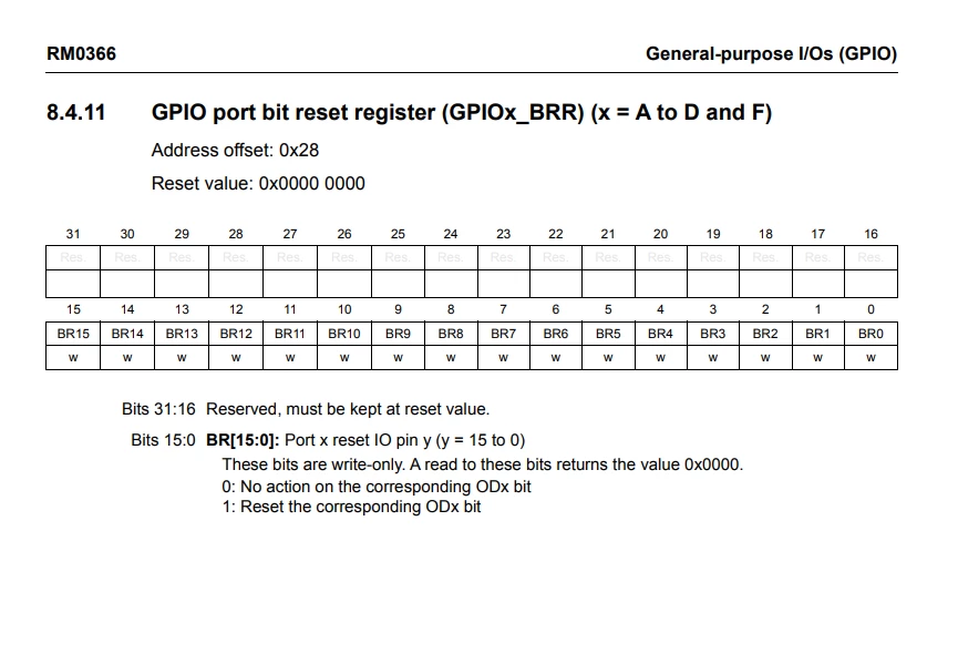

RM0366 Reference Manual GPIO BRR Inconsistency
  • August 27, 2026
  • 1 reply
  • 11 views

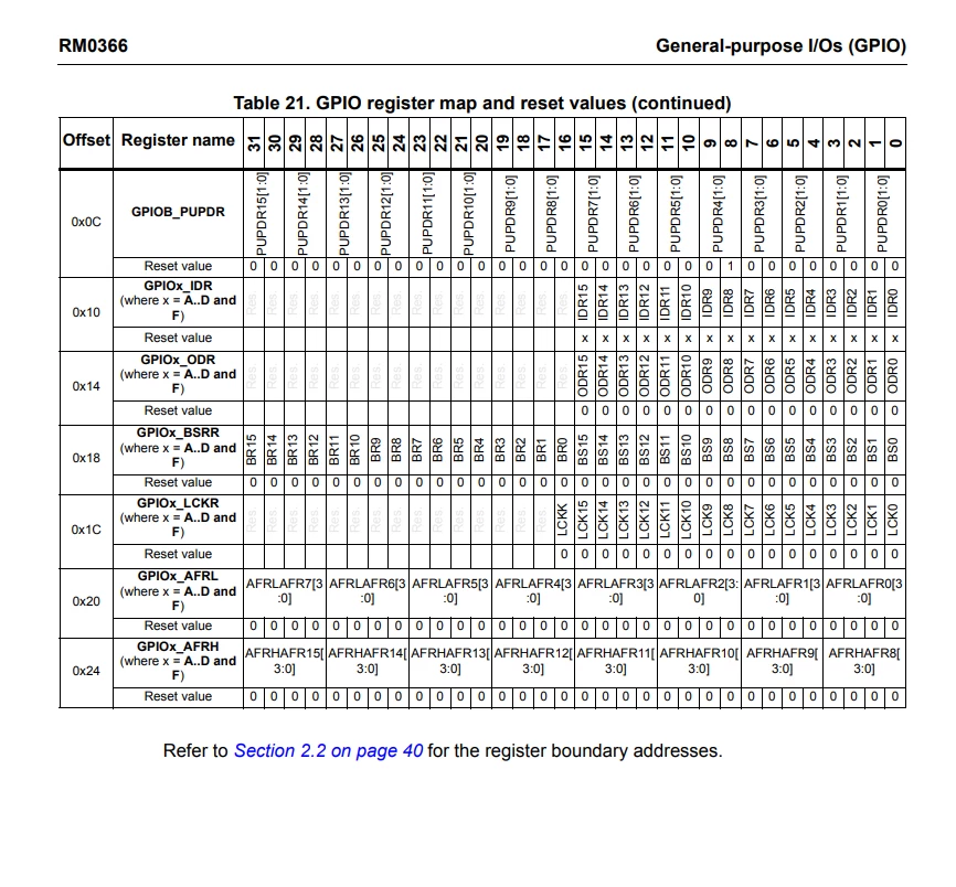

In RM0366 Reference Manual GPIO section it says that there is a BRR register at offset 0x28 but in the GPIO register map its not shown. I assume this is a mistake but I want to know if STM32F301C8 has a BRR register.
1 reply
August 27, 2026
looks confused to me as well. It seems there are something missing at GPIO register map...
