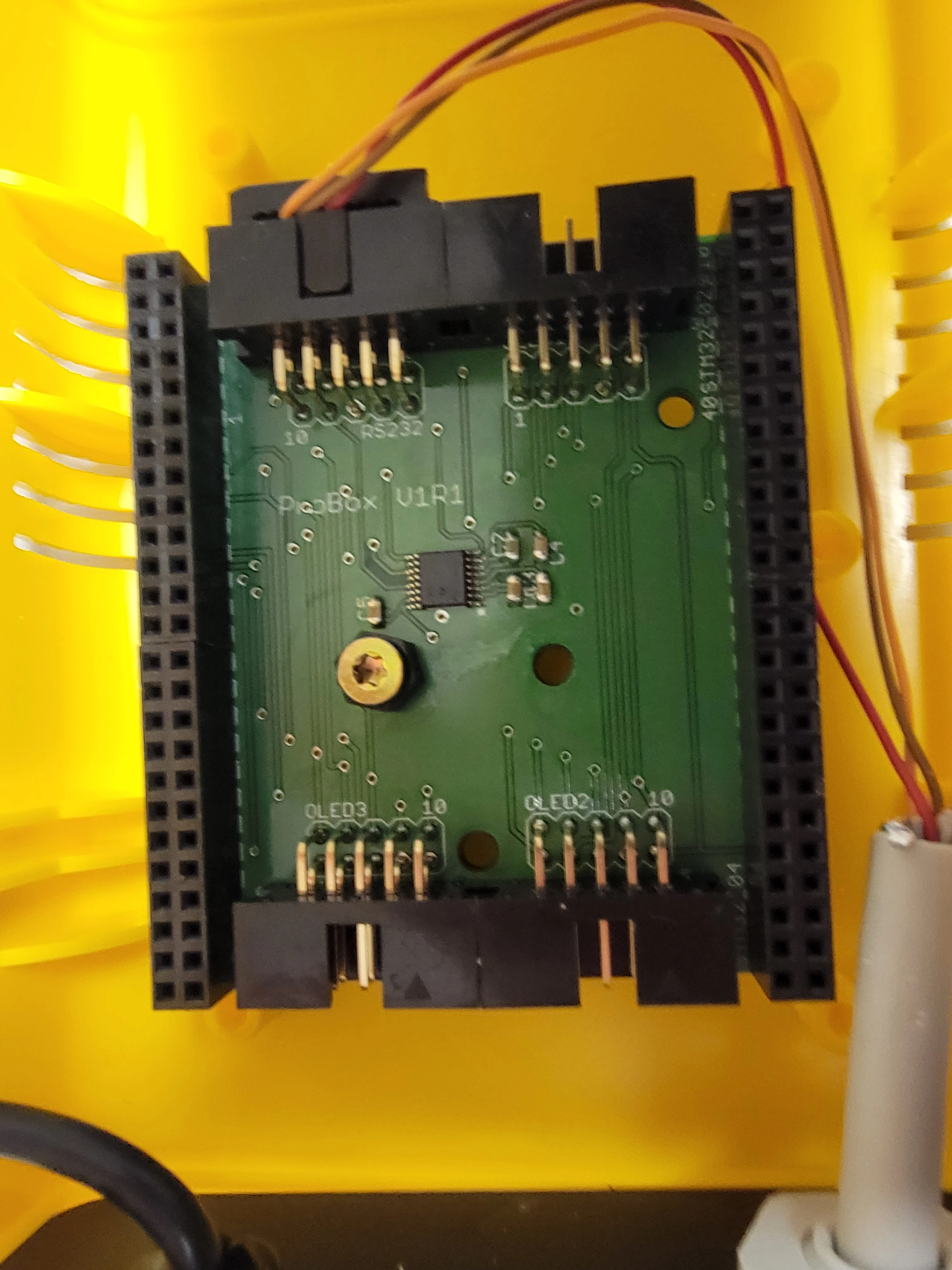

Resources for MB997C compatible RS232 daughter PCB and PCB reverse engineering
I am trying to troubleshoot and reverse engineer a project no longer in production and for which the developer is no longer reachable.  The project is based on the ST MB997C and uses an attached daughter board that serves as an R232 communications interface to external I/O (whatever other functions it may perform are unclear).  Are there PCB suppliers that manufacture MB997C compatible PCBs to provided specifications?  The subject PCB in this project is silkscreened with the project name "ProBox V1R1", so it is not a generic OTS part.  Also, are there resources out there that can reverse engineer the functions of this PCB?  Any guidance would be greatly appreciated.

Apr 27, 2026 11:16 AM UTC
Hello @bitSync and welcome to the ST community,
What do you mean by "ST MB997C"? STM32F4DISCOVERY board?
I don't think "ProBox V1R1" board is a ST product we don't know how to help here..

Andrew Neil
Apr 27, 2026 11:32 AM UTC
Googling* "ProBox V1R1" finds this:
https://www.facebook.com/groups/1454328184881203/posts/3897897383857592/
in a group about "Mackie d8b".
Maybe that would be a better place to ask about this?
As to general resources for reverse-engineering PCBs, just visual tracing of the tracks and/or a continuity checker.

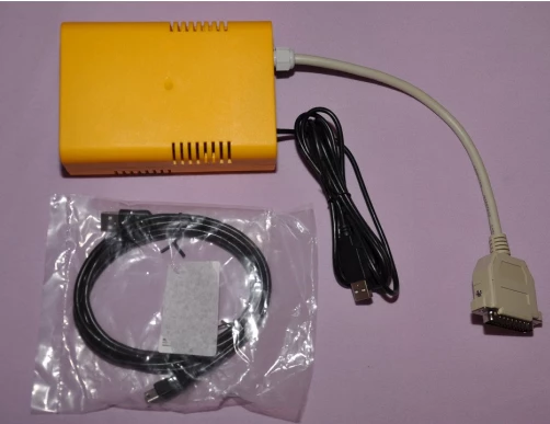

Adding "mackie d8b" to the search finds this:
http://www.probox-controller.com/downloads/documentation/user_manual_V2-01-17-1.pdf
Which contains this picture:
Is this the product you're talking about?
If so, there's a contact email address in that document.
Other resources here: http://www.probox-controller.com/

Another FB thread of people reverse-engineering (what appears to be) this thing:
https://www.facebook.com/share/p/1asamYwLJH/
This post concludes that the board just provides an RS232 transceiver:
https://www.facebook.com/groups/1454328184881203/posts/3867040220276642/?comment_id=3867247823589215&reply_comment_id=3867291836918147
bitSyncAuthor
Apr 27, 2026 1:31 PM UTC
Yes, thank you. I'm familiar with those FB posts and I've been posting in that group on this subject.
I believe I have found some resources for baseboard production. Thanks.
