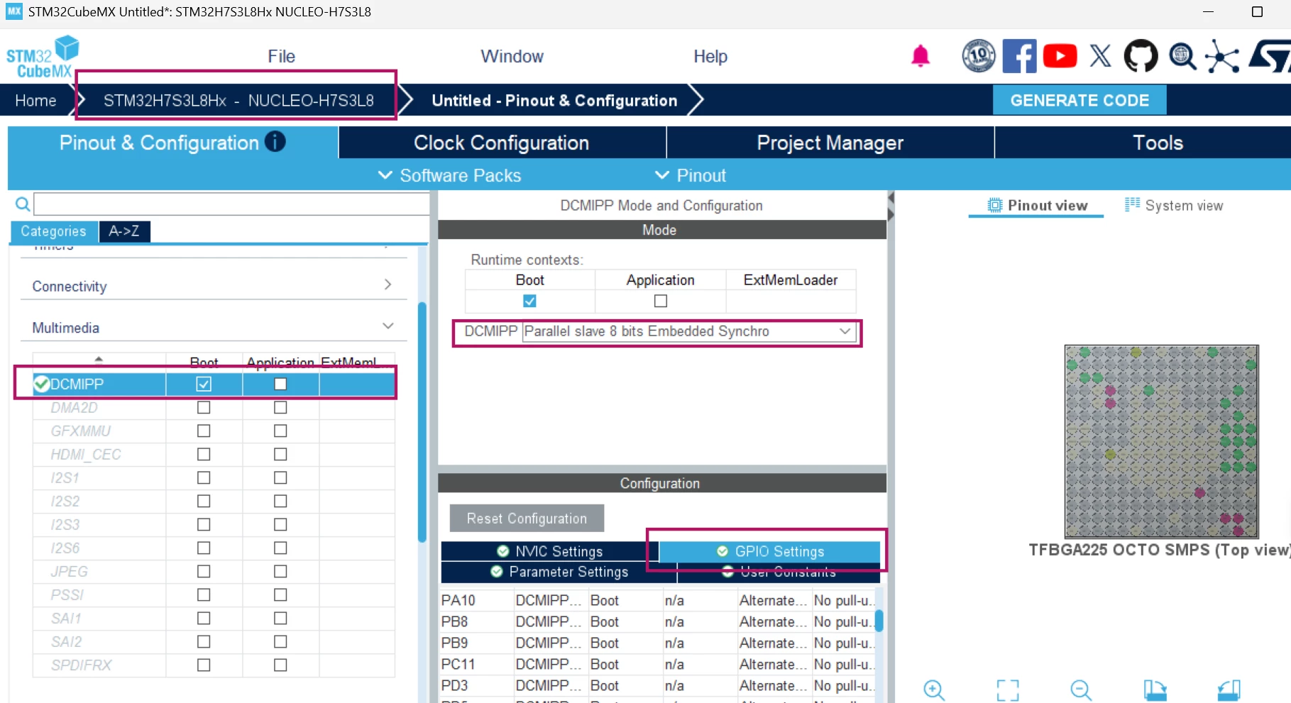

To find the suitable pins you can use STM32CubeMX

I recommend you to check the pins conflicts with Ethernet and external flash using STM32CubeMX tool.
