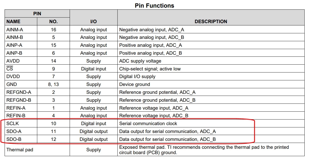

I have the TI ADS8350 and want to read both channels in parallel. They support SPI, but I can not figure out how to setup the dual SPI for this. Another way would be to use DMA, could someone point me in the right direction. I am using SMT32F412.

In SPI terms, Looks like it has a single SCLK, two MISOs, and no MOSI:

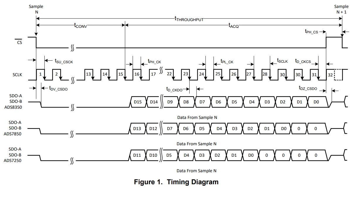

So the start of the read is triggered purely by /CS:

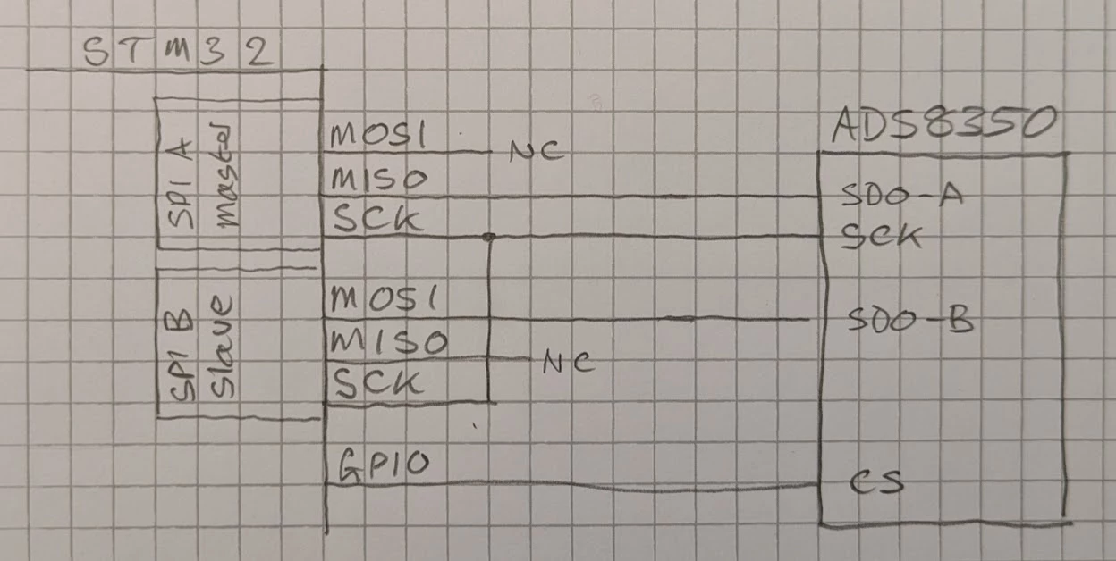

So maybe try:
  • Use one SPI as Master, to generate the clock
  • Use another SPI as Slave, clocked by the Master
You'll need to manually control /CS anyhow to get the tCONV timing

Looking at it again, it seems that  tCONV isn't (just) a time - it's a number of clock cycles.
You should be able to get that by the Master clocking-out a 16-bit value (just a dummy that gets ignored).

You could still try the Master + Slave, and get the Master to give the 16 clocks as suggested?
Should be easy enough to try ...

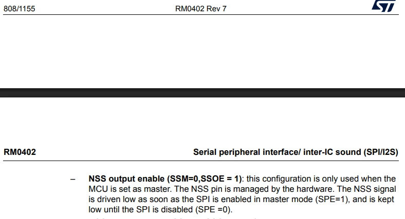

The F4 does have a kind of hardware /CS control:

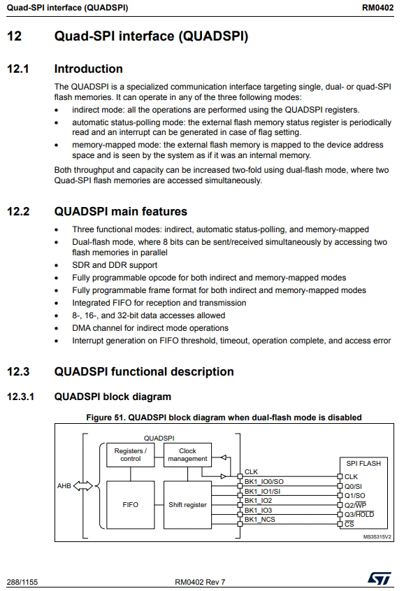

https://www.st.com/resource/en/reference_manual/rm0402-stm32f412-advanced-armbased-32bit-mcus-stmicroelectronics.pdf#page=809
Maybe that could be made to work?
There's also QUADSPI ...
