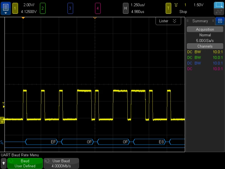

@Beartama wrote:
I already had the output hooked up to an oscilloscope and the output waves look correct.
Please share scope screenshots - someone may be able to spot something...
If your scope has a screenshot facility, please use it - this will be far better than trying to photograph the screen!
The high spike is for bit 1 to be sent to the LED, and the low spike is for bit 0. The high spike is high for 0.75us and the low spike is high for 0.375us, these are according to the spec of WS2812B.

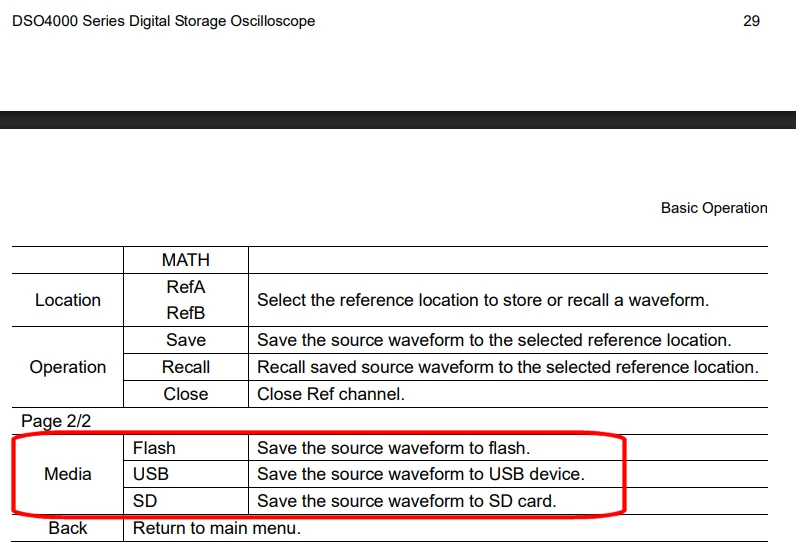

Your scope does have that facility:
Anyhow, that waveform looks terrible: there should be clear pulses with clean edges, and consistent height; eg,
from: https://www.pjrc.com/2017/10/

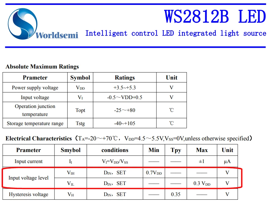

PS:
From the LED datasheet:
You haven't shown what your VDD is for the LEDs but, if it's 3.3V, that would mean that the minimum 'High' voltage is 2.3V.
In your scope trace, the short spikes aren't even reaching 2V, and even the tall ones are marginal.
