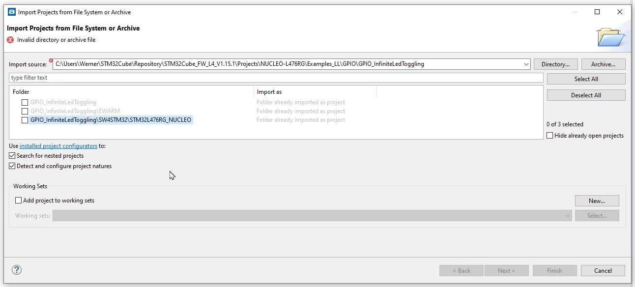

Carefully following the instructions I got with my STM32 Nucleo board I am trying to opent the:
C:\Users\myname\STM32Cube\Repository\STM32Cube _FW_L4_V1.11.0\Projects\NUCLEOL476RG\Examples_LL\ GPIO\GPIO_InfiniteLedToggling
Then project:
GPIO_InfiniteLedToggling\SW4STM32 \STM32L476RG_NUCLEO
I am getting the error: Invalid directory or archive file? And am not able to click checkbox.
Thanks for the help!

It says "the folder is already imported". Looks like the Eclipse workspace is garbaged.
Create a new empty workspace folder and import this into it.

Hi Pavel,
Thanks so much for the help! I did as you said and did get things working. After spending the day with TrueStudio I am afraid it is just way to complicated of a program for me. Too much time involved just to get the simplest things to work.
