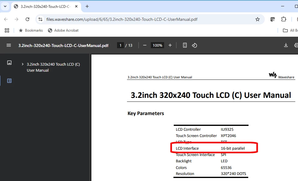

Best answer by RobK1
Well, I hate to tell you this, but your display is not SPI, but 16-bit parallel.
The SPI is used to read out the touchscreen data.
4 replies
RobK1
RobK1Best answer
April 1, 2025
Indeed:

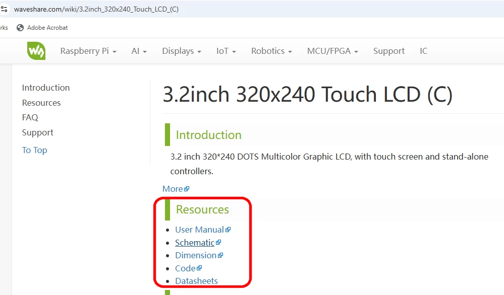

@kiwiosek2007 the datasheet is available from the page you linked:
https://files.waveshare.com/upload/6/65/3.2inch-320x240-Touch-LCD-C-UserManual.pdf
See also the schematics linked from that page.
There is also code:
