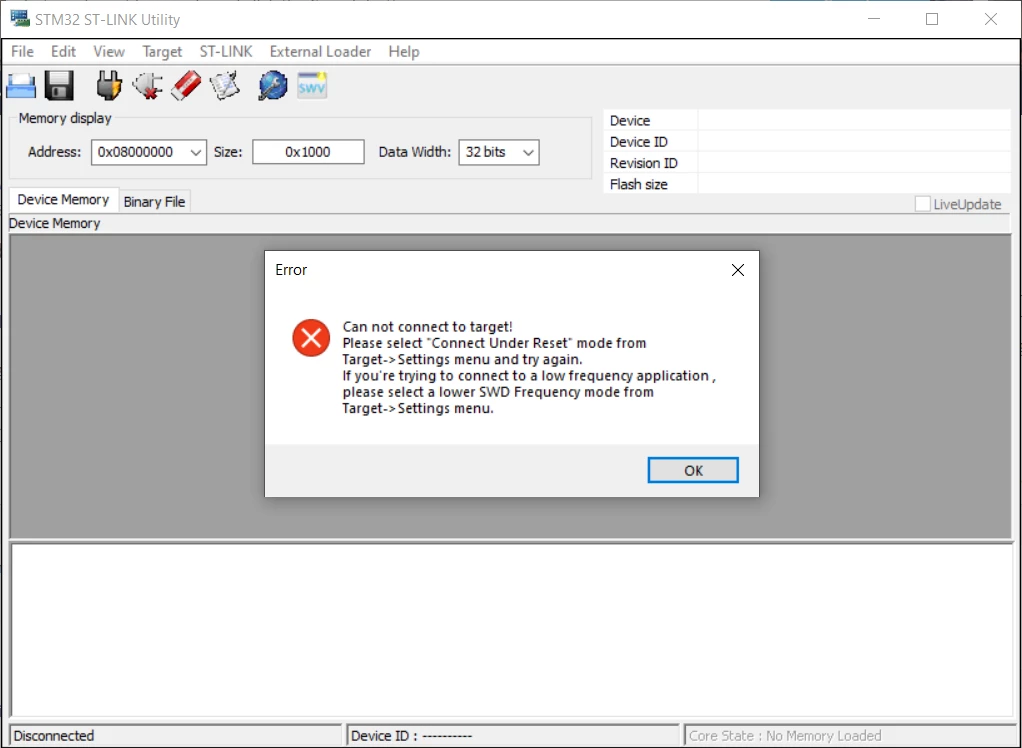

Furthermore, I can't connect to the board using STLink Utility:
0693W000005CNMnQAO.pngI selected "Connect under reset" and reduced the frequency as recommended by the error message - still can't connect.
I have also tried powering the board externally - LED5 lights up as expected. I am able to power the board externally and plug the debugger into the PC with no additional issues (still can't connect). I can read varying voltages on the GPIO so I don't that any circuitry has been damaged.
Is it possible that the program I uploaded has irreversibly locked me out of the STLink connection?

ASaye.2AuthorBest answer
Nov 26, 2020 4:39 PM UTC
Solved - I believe I was locked out of the STLink because of a mismatch between the firmware and hardware configuration of the on board power supply. I was able to boot from system memory by pulling BT0 high, then perform a full chip erase in STCubeProgrammer to remove the firmware that incorrectly configures the power supply, and now I can upload other programs/firmware that contain the correct power supply configuration.
