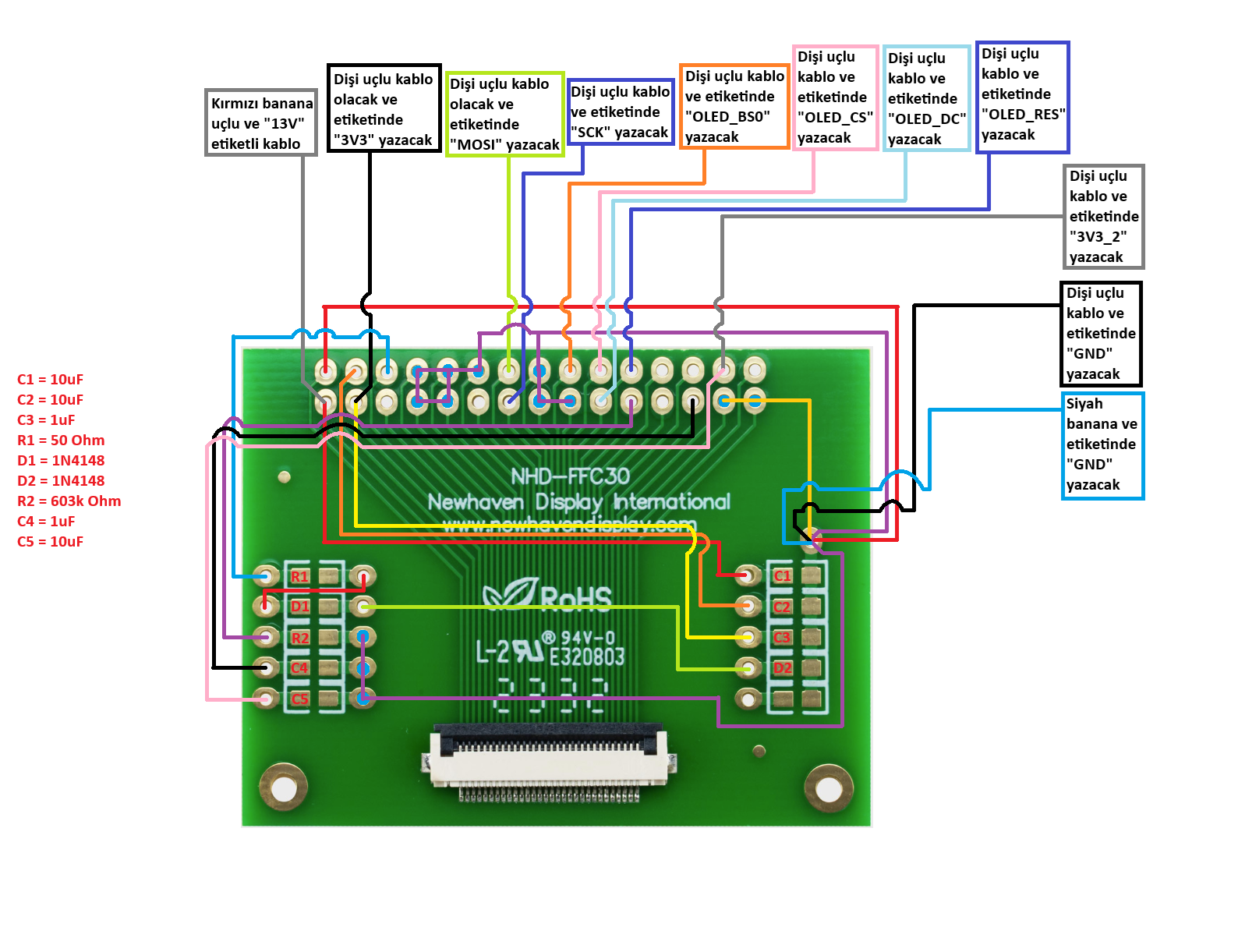

NHD-1.5-128128G (SSD1351) — completely unresponsive despite verified wiring, timing, and command sequence
Hi all,
I'm driving an NHD-1.5-128128G (SSD1351 controller, 4-wire SPI mode) from an STM32F303RE (Nucleo board) using the hardware SPI2 peripheral. The display has never lit up, and I've now run out of obvious things to check, so I'd appreciate a second pair of eyes.
Setup
  • Display: NHD-1.5-128128G
  • Interface: 4-wire SPI (BS1=0, BS0=0, both tied to GND)
  • MCU: STM32F303RE, HAL library, hardware SPI2 (not bit-banged)
  • Pin mapping: CS, D/C, /RES driven as GPIO outputs; SCLK/SDIN via SPI2 hardware lines
Power rails (all measured at the panel/FFC connector end, not just the breakout header)
  • VCC: 13.0 V (measured on oscilloscope, confirmed at the connector)
  • VCI: 3.3 V
  • VDDIO: 3.3 V (measured directly at pin 4)
  • VDD: not externally driven, only a 1 µF cap to GND per datasheet
  • VCOMH / VSL: only connected to their respective decoupling caps per the reference schematic, no external drive
What I've verified works correctly
  • /RES toggles LOW→HIGH with correct timing (confirmed on scope)
  • D/C toggles between command/data writes as expected
  • /CS goes low during transactions
  • SPI clock and MOSI (SDIN) are both active during transactions (confirmed with scope)
  • Tried both SPI Mode 0 (CPOL=0, CPHA=0) and Mode 3 (CPOL=1, CPHA=1) — no difference
  • Tried SPI clock speeds from ~9 MHz down to a very low prescaler — no difference
  • Re-seated the 30-pin 0.5mm FFC connector fully (heard the latch click)
  • Initialization sequence copied byte-for-byte from the datasheet's "Example Initialization Sequence" section (unlock via 0xFD/0x12 + 0xFD/0xB1, then 0xAE, 0xB3/0xF1, 0xCA/0x7F, 0xA2/0x00, 0xA1/0x00, 0xA0/0xB4, 0xB5/0x00, 0xAB/0x01, 0xB4/0xA0,0xB5,0x55, 0xC1/0xC8,0x80,0xC8, 0xC7/0x0F, 0xB9, 0xB1/0x32, 0xBB/0x17, 0xB2/0xA4,0x00,0x00, 0xB6/0x01, 0xBE/0x05, 0xA6, clear GDDRAM, 0xAF, then 0x5C)
The key diagnostic I ran Since this panel doesn't expose an SDO/MISO line in 4-wire SPI mode, I can't read back register state directly. So instead I measured DC current draw in series with the VCC (13V) line while toggling between:
  • 0xAE (Display OFF / Sleep)
  • 0xA5 (Display All ON — forces every pixel on regardless of GDDRAM content)
Per the datasheet, ICC should go from sleep-level (µA range) up to ~33–42 mA typical when all pixels are forced on. I'm seeing zero measurable change in VCC current between these two states — the current stays flat regardless of what command is sent.
My interpretation, and where I'm stuck Since VDDIO (I/O supply) is confirmed present at 3.3V, and CS/D-C/RES/SCLK/SDIN are all toggling correctly on the scope, I would expect the controller to at least respond to 0xA5 by drawing more current from VCC — even if every other register setting were wrong. The fact that VCC current doesn't move at all under any command makes me suspect one of:
  1. A break in continuity between the FFC connector and the actual VCC pad on the panel's internal flex, despite VCC reading correctly at the connector
  2. The SSD1351 die itself is not responding to any command (possible latent damage, though I have no known overvoltage event on this specific unit)
  3. Some interaction between the two "VSL" data bytes sent via command 0xB4 (0xA0, 0xB5, 0x55) and the segment low voltage circuit — I based this on the datasheet's own example, but I'm not fully certain about the "external VSL" hardware requirement that the SET VSL command references (footnote in the command table mentions an external circuit is needed when external VSL is selected — Figure 14-1)
My question for the forum:
  • Does the "external VSL" configuration in the 0xB4 command actually require additional external components (beyond what's on the reference breakout board) to avoid faulting the display enhancement circuit? I want to rule this out before assuming the panel itself is dead.
  • Is there a more direct way to confirm the controller is receiving/parsing SPI commands at all, given there's no SDO line in 4-wire mode?
  • Has anyone seen a similar "zero current draw regardless of command" symptom that turned out to be something other than a dead panel or a connector fault?
Happy to share scope captures of the SPI transactions and my full init sequence if that's useful. Thanks in advance for any pointers.
This image is my schema
