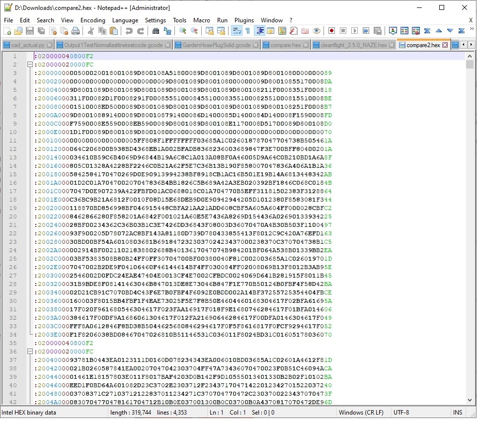

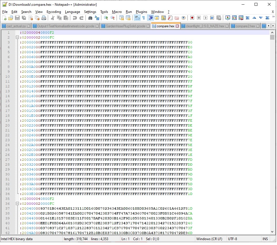

Hi - I took a new Flip32 Flight controller board out of its sealed bag and reflashed the latest clearflight firmware (cleanflight_2.5.0_NAZE.hex) using the Flash Loader Demonstrator onto the board in Boot mode. ( I also tried clearflight configurator, and STM32CubeProgrammer)
It accepted the flash hex file and I could read the contents back and they were correct. But as soon as I power cycle back to run the program, it doesnt run, and upon investigation, the contents of Page Zero(0x08000000-EFF) are all 0xFFFFFFFF
There are no option bits set that I can see that would lock this memory from reading it, and the software doesnt run.
Does anyone know how can this be and how to resolve it?

SDyer.1
SDyer.1Author
Jun 4, 2020 3:02 PM UTC
Thanks for your replies -
@TDK​  I have to assume the software is not the problem because its released publically. https://github.com/cleanflight/cleanflight/releases
@Community member​  Yes I can view and compare the program before and after reboot at address 0x08000000
Before and after reboot:
Jun 4, 2020 3:19 PM UTC
You really think all software available online is free of bugs? Anyone can upload to github. There are no quality checks.
Change the first few bytes right at 0x08000000 to 0xFF (to prevent the code from doing anything useful), then reset, and see if the entire page 0 is still reset or not.
