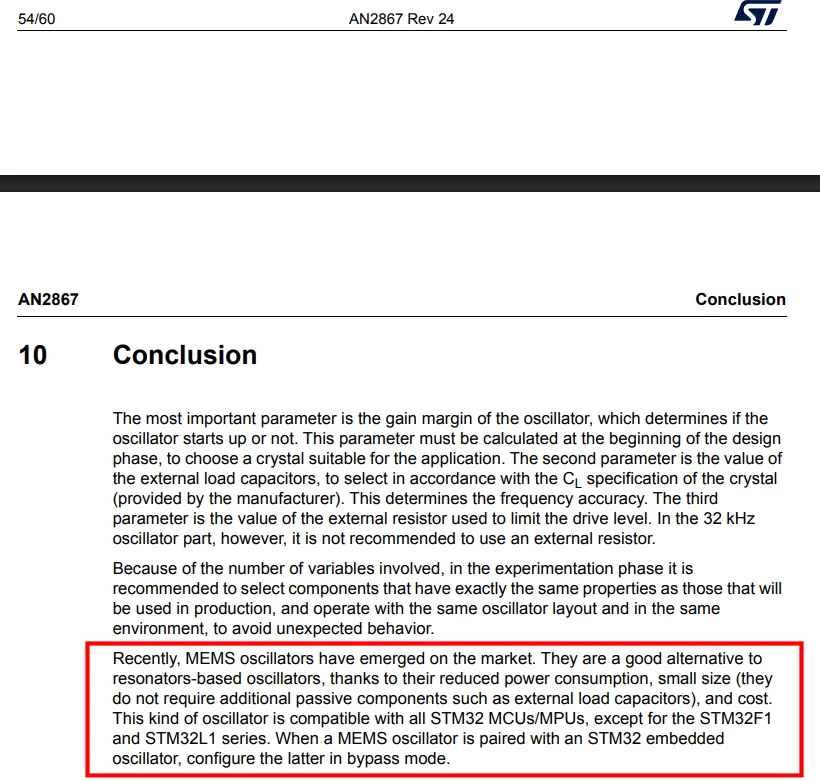

when I measured waveform at quartz crystal mounted on STM32F407 board

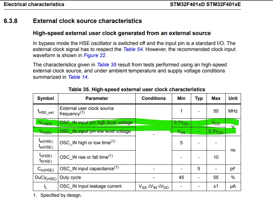

The specs you showed are for when OSC_IN is used as a digital input - not when it is used as an oscillator with an external crystal.
So you just need to ensure that the output signal from your MEMS oscillator complies with those specifications.
What about VDD of MEMS Oscillator?
That’s entirely irrelevant to the STM32: all that the STM32 sees is the signal arriving at its OSC_IN pin - it neither knows nor cares where that come from, how it was generated, or how the source was configured.
https://www.st.com/resource/en/application_note/an2867-guidelines-for-oscillator-design-on-stm8afals-and-stm32-mcusmpus-stmicroelectronics.pdf#page=55
For an explanation of the F1 & L1 exceptions, see:
PS:

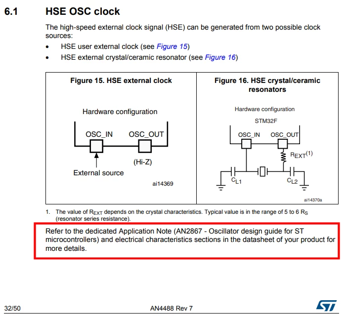

Note that AN2867 (where the above screenshot comes from) is specifically referenced from AN4488  Getting started with STM32F4xxxx MCU hardware development:
You should also review the rest of your design against that App Note ...

  1. The STM32F401 manual says
    but when I measured waveform at quartz crystal mounted on STM32F407 board , The waveform is from 2.3V to 1.2V  with frequency at 8 Mhz with VDD at 3.3V.  so I am having doubt on clock level voltage inputs required when using MEMS oscillator.
