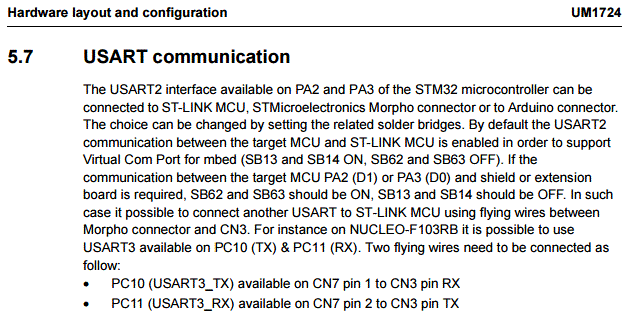

I have already asked this question on the mbed site:
https://developer.mbed.org/questions/59656/Serial-What-are-the-Supported-pins/
It isn't clear from the Handbook whether this is even supposed to be supported. I tried instantiating as:
Serial uart4( PC_10, PC_11 );
But is seems that can't be sufficient, as USART3 can also use PC10 & PC11 - so how could it know?! #fail #nucleo #nucleo #uart #mbed #possibly-worst-forum-software #serial #keil #mbed

Well the ST-LINK VCP is definitely USART2 via PA2/PA3 on the
https://developer.mbed.org/platforms/ST-Nucleo-L152RE/
But somewhat irritatingly that conflicts with the D0/D1 of the header.
I'd have to wade through the manuals for USART3/UART4, but I could swear you'd have to manually modify the board to get those to the VCP TX/RX pins.

Sorry - I'm not talking about the
 ST-LINK VCP  here at all.
I have serial comms with the PC over the
ST-LINK VCP  working fine.
What I'm looking to do is to also have UART (or USART) comms on the header pins.
The UART4 pins seemed initially convenient - but any other pins would do.
I'm also not much into mbed (yet) - but the documentation on this does seem very skimpy (being kind).
