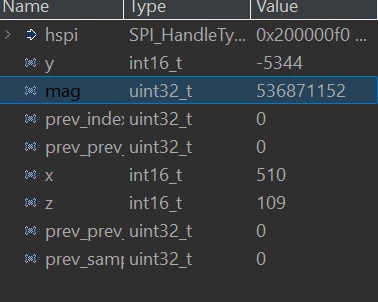

I work on a pedometer project, which uses built-in accelerometer and an LCD screen (ILI9341). The screen code works fine, but I struggle to get the pedometer part to work. I suspect there might something wrong with how I initialized the accelerometer, since it outputs weird values.
I use an stm32f407g-disc1 board with built-in accelerometer, which I communicate with via SPI. I find the values it returns very weird, since I don't move the device at the moment. Shouldn't they be close to zero since there is no acceleration? Moreover, they don't change when I shake the device slightly, although it may be because the acceleration is not big enough to be detected. Another problem is that mag value changes all the time, although x,y,z don't change.
Values

 Accelerometer read, write and initialization functions
#include "accelerometer.h"
void accelerometer_read_all_axes_dma(uint8_t src[6], SPI_HandleTypeDef *hspi1) {
	uint8_t tx[7] = {OUT_X_L | 0x80, 0, 0, 0, 0, 0, 0};
	uint8_t rx[7];
	HAL_GPIO_WritePin(ACC_GPIO_PORT, ACC_GPIO_PIN, GPIO_PIN_RESET);
	HAL_SPI_TransmitReceive_DMA(hspi1, tx, rx, 7);
	HAL_GPIO_WritePin(ACC_GPIO_PORT, ACC_GPIO_PIN, GPIO_PIN_SET);

 Acceleremoter RxTx interrupt
//spi callback function
void HAL_SPI_TxRxCpltCallback(SPI_HandleTypeDef * hspi)
	if(hspi == &hspi1) {
		//declare variables
		int16_t x, y, z;
		uint32_t mag;
		uint32_t prev_index, prev_prev_index, prev_sample, prev_prev_sample;
		prev_index = 0; prev_prev_index = 0; prev_sample = 0; prev_prev_sample = 0;
		//calculate magnitude
		x = (int16_t)((int16_t)xyz_data[0] | ((int16_t)xyz_data[1] << 8));
		y = (int16_t)((int16_t)xyz_data[2] | ((int16_t)xyz_data[3] << 8));
		z = (int16_t)((int16_t)xyz_data[4] | ((int16_t)xyz_data[5] << 8));
		mag = ((int32_t)x*x + (int32_t)y*y + (int32_t)z*z); //auto-convert float to int //was sqrt

My pedometer still doesn't work, but I have solved this specific issue. The problem was in how I update xyz_data. This is the correct way to do this.
void HAL_TIM_PeriodElapsedCallback(TIM_HandleTypeDef* htim)
	 if (htim->Instance == TIM2) {
		 if ((draw_ready == 1) && (accelerometer_ready == 1)) {
			 accelerometer_read_all_axes_dma(xyz_data, &hspi1);
	 //else if (htim->Instance == TIM3) {
	 //	 if (draw_ready == 1) {
			 //steps_count += 1;
			 //update_lcd_flag = 1;
void accelerometer_read_all_axes_dma(uint8_t src[7], SPI_HandleTypeDef *hspi1) {
	uint8_t rx[7];
	HAL_SPI_TransmitReceive_DMA(hspi1, tx, src, 7);
	//memcpy(src, &rx[1], 6);
volatile uint8_t xyz_data[7];
