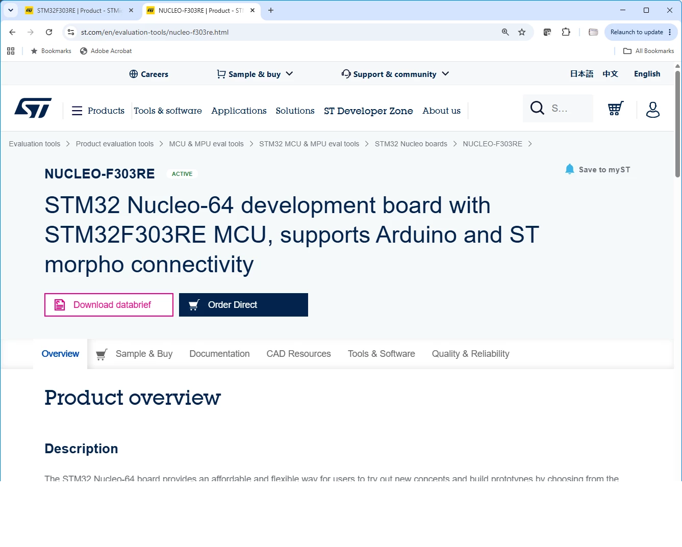

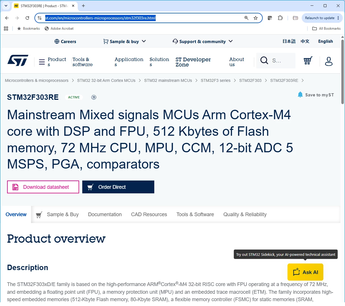

Andrew Neil
Jul 24, 2026 1:25 PM UTC
Specifically for ST products - including STM32 microcontrollers - your key point of reference is the Product Page; eg, for the STM32F303RE:
https://www.st.com/en/microcontrollers-microprocessors/stm32f303re.html
  • Look on the Documentation tab for the datasheet, reference manual, application notes, etc
  • The CAD Resources tab for schematics, symbols, etc
  • The Tools & Software tab for supporting hardware (dev boards, etc) and software tools.
Similarly for the NUCLEO-F303RE board:
https://www.st.com/en/evaluation-tools/nucleo-f303re.html
