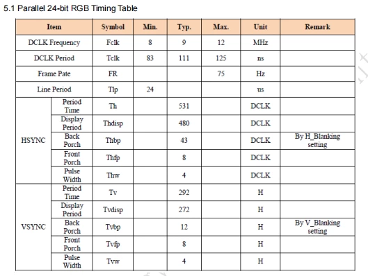

hi i have been working to intergrate a parallel RGB dispay with stm32h7A3ZIT6 with the help of LTDC . and pretty much made it working the display has this configuration  .

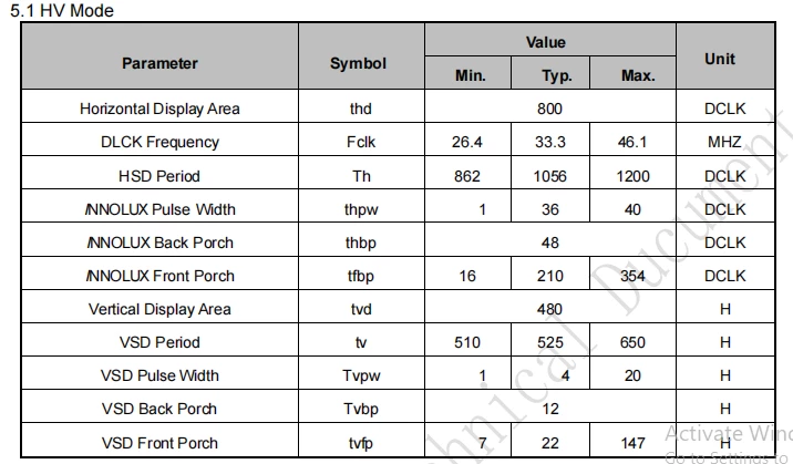

this one worked pretty well with the stm LTDC and then i bought a new display it has a differnt configurations like this
this one is in HV mode whats changed? can i stilll use stm ltdc to drive this . and whats the differance between these displays.????
