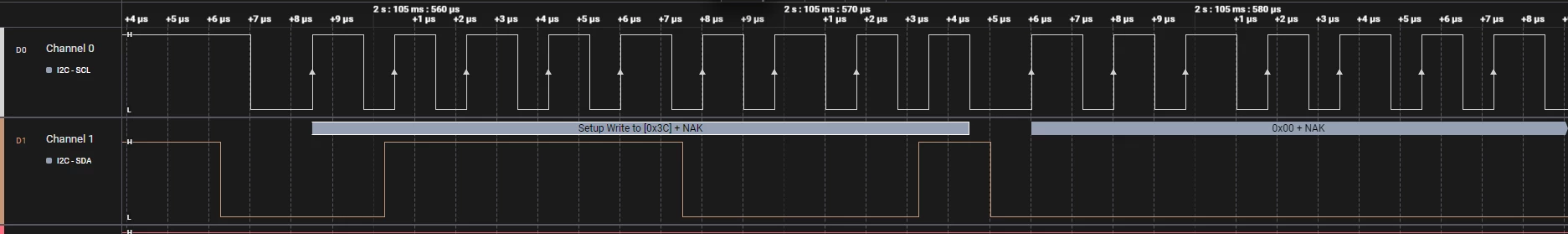

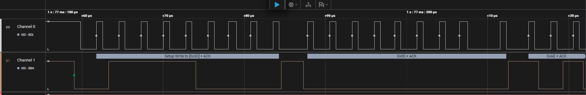

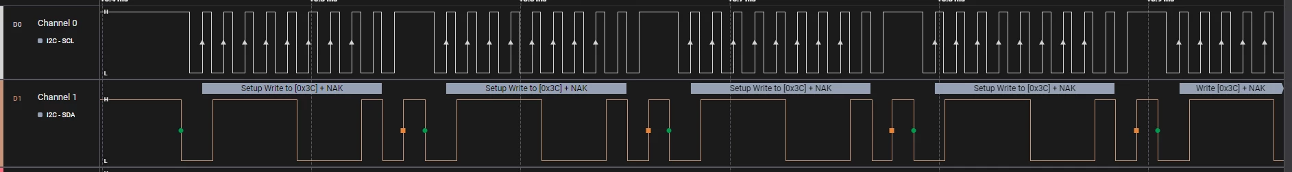

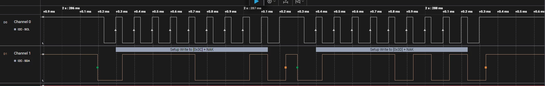

Hello, i have a problem with I2C SSD1317 OLED display in combination with STM32. On arduino it works. On STM it works with other controllers but not with SSD1317. Display is working and address is ok (because it's working on Arduino). I tried different speeds and pullups.
Arduino and SSD1317:
STM32 and SSD1306:
STM32 and SSD1317:STM_SSD1317.png

Andrew Neil
Sadly, that doesn't follow at all: different software frameworks have different ways of presenting the I2C address - whether the 7 bits are presented left- or right-aligned.
https://community.st.com/t5/others-stm32-mcus-related/i2c-communication-between-stm32l4r5-and-esp32/m-p/767914/highlight/true#M8548
Rather than just randomly trying things, have you actually looked at the signals with an oscilloscope?
Check for good, clean edges, signal levels, noise, etc.
If these things are not right, a logic analyser can give misleading results...
What "Arduino", exactly, did you use?
Remember that many Arduinos are 5V, but STM32 is only 3V ...
Note that there is an Arduino core for STM32: https://www.stm32duino.com/
https://github.com/stm32duino
Jakub Augustyn
I think it is not an STM problem. It is a problem with weird SSD1317 inicialization / configuration. I think that Arduino is not waiting for ACK and this is why it is working.
Display doesn't respond for "HAL_I2C_IsDeviceReady" addres 0x3C and 0x3D.
I used Arduino Nano.
Arduino and SSD1317 also has a NAK.
A NAK indicated the hardware is not correct.. misconfigured or not powered or miswired.
