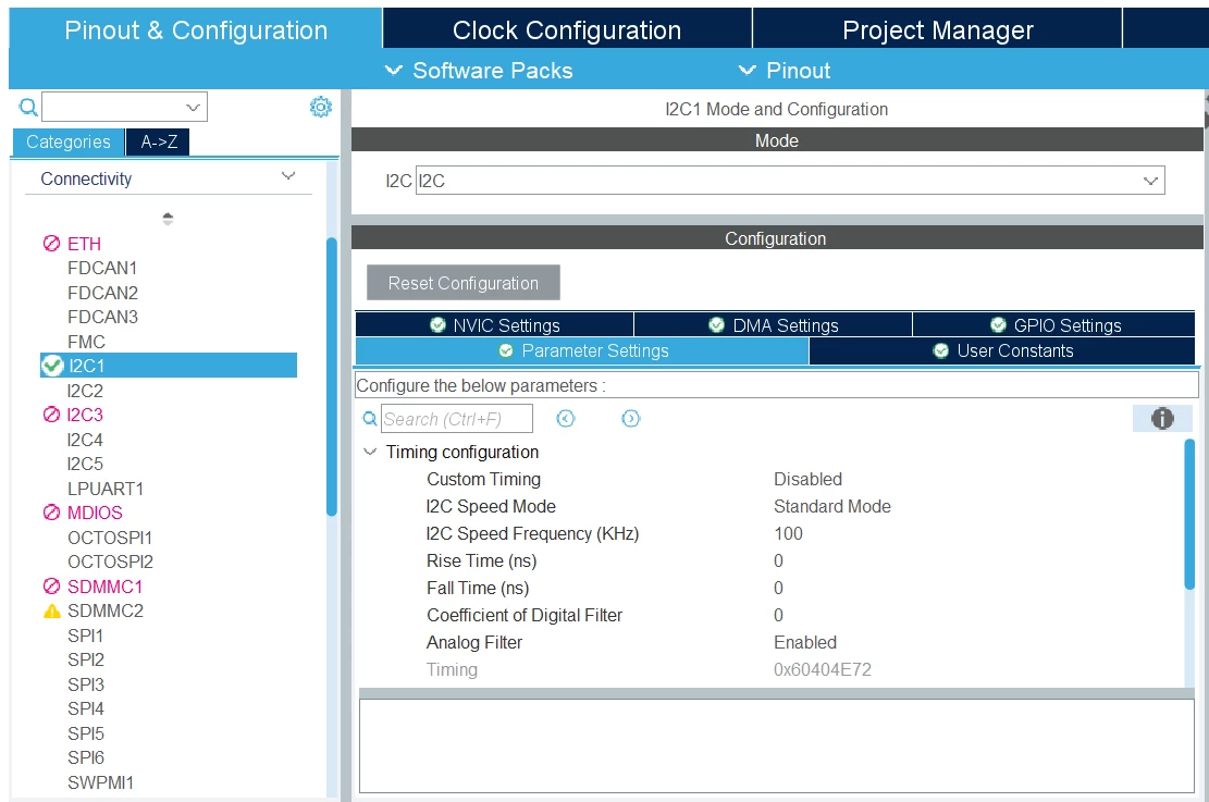

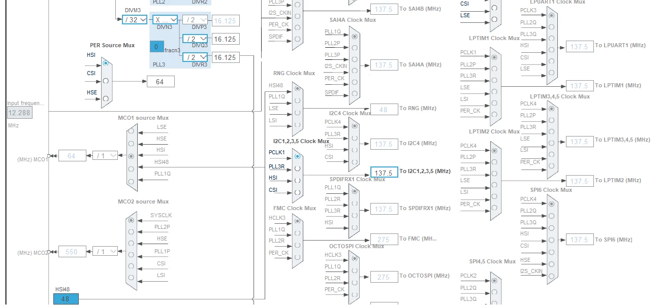

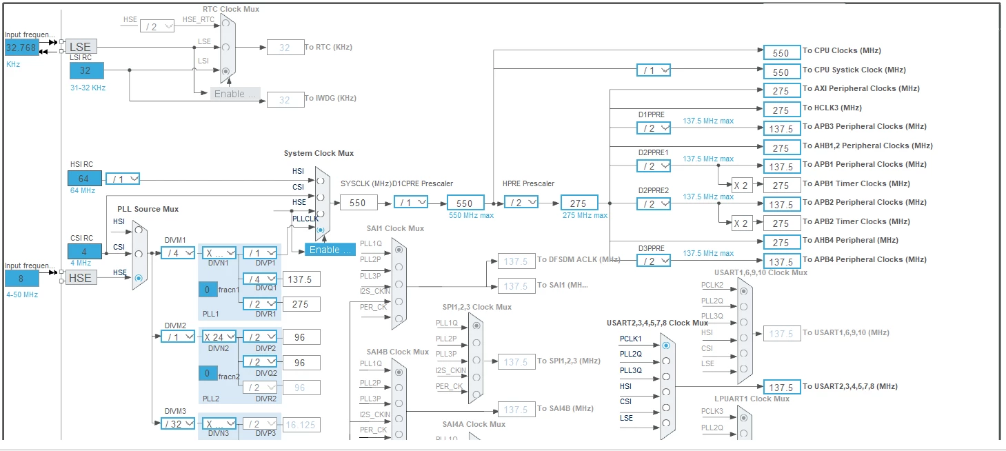

This is the clock configuration:
Then I activated the I2C1 as follow:
I used the pins PB8 and PB9 for SCL and SDA:

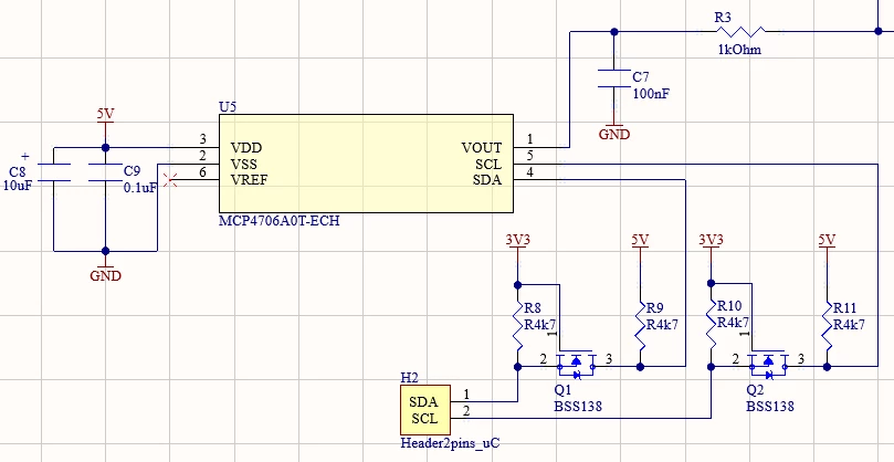

I've this circuit connected to the microcontroller:
Using an oscilloscope and a multimeter I'm always measuring 0V and I can't see the SCL and SDA signals.
Do you know where am I doing wrong?

Andrew Neil
December 30, 2025
Have you checked that there's nothing on the Nucleo board already using these pins?
You seems to have some 3-to-5V translation going on, and at least 1 connector - so where, exactly, are you measuring?
The MCP4706 can work at 3V - so have you tried a direct connection?
DannyBAuthor
December 30, 2025
I checked the pin and it should be okay.
On the oscilloscope Im measuring directly on the I2C connector pins. With the Multimeter Im measunig on the output voltage of the DAC, so on the resistor R3.
No, I didn't tried a direct connection
