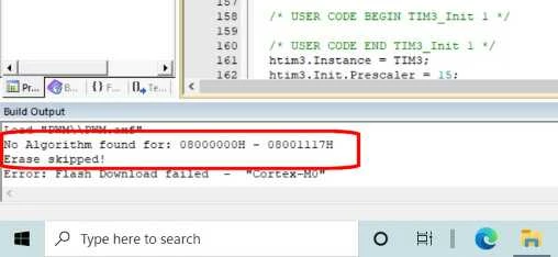

You need to pay attention to what it's telling you in the 'Build Output' window:
0693W000008xNvpQAE.jpgNote that you can copy & paste the text from that window - which is often more useful than a screenshot.
So your Flash Algorithm is not correctly configured; this is part of the Debug configuration in the Project options - though it should have been automatically set by the target chip selection

In project options go to debug settings and under the flash settings add in the STM32 part you are using.​
