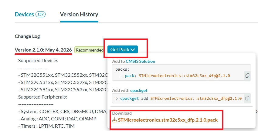

Download the pack from ARM website: https://www.keil.arm.com/packs/stm32c5xx_dfp-stmicroelectronics/versions/
In the format of STMicroelectronics.stm32c5xx_dfp.x.y.z.pack
Than double click on the downloaded file and follow the steps.
After you should able to see STM32C5 series in the device menu:
Refer also to this link: https://dev.st.com/stm32cube-docs/stm32c5xx-dfp/2.0.0/en/patch/mdk.html
Hope that answers your question.
