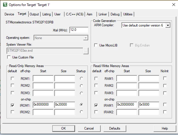

How to print Float values on Keil IDE
0693W000008zC2XQAU.pngI am developing a bare-metal project using the stm32F103 MCU, under Keil Uvision IDE,
I am not able to print the float values (from the temperature sensor), but it works fine with an integer.
Is there a method to use ,? I tried to implement another printf library but it doesn't work with float.
I have no option to select float value in my IDE as shown in the image.
Thank you.

Check Use MicroLIB, should by default support printf("%lf\n",x) or dtoa()

I have checked MicroLIB, my compiler shows these errors :
.\Objects\float.axf: Error: L6218E: Undefined symbol __use_two_region_memory (referred from startup_stm32f10x_md.o).
.\Objects\float.axf: Error: L6218E: Undefined symbol __initial_sp (referred from entry2.o).

Use a template
STM32Cube_FW_F1_V1.8.0\Projects\STM32F103RB-Nucleo\Templates
or
Use the startup from here
STM32Cube_FW_F1_V1.8.0\Drivers\CMSIS\Device\ST\STM32F1xx\Source\Templates\arm\startup_stm32f100xb.s
