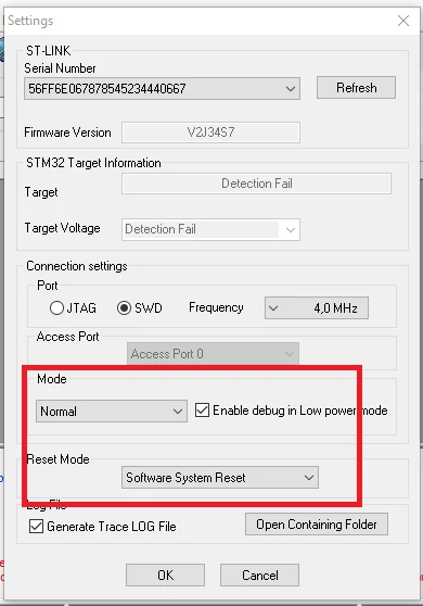

How to change ST-LINK settings in SW4STM32 IDE
I have a probably simple question: Where I can change ST-LINK Settings in System Workbench IDE. For example in ST-LINK Utility in Settings I can change Reset Mode to Software System Reset,
and I don't know where I can find this setting in IDE.
I have this problem without this setting changed:
BR, Daniel

Click on the project name in the "Project Explorer" window on the left edge. Then go to the "Run" menu and select "Debug Configurations". In the dialog that comes up, on the left side under "Ac6 STM32 Debugging" click on the profile you want to change. In the right side, click on the "Debugger" tab. Look in the "Configuration Script" section. If "Automated Generation" is selected, then click on the "Show generator options" button. You should be able to change the reset mode there.

Mar 27, 2020 7:33 PM UTC
Dear Bob S,
thank you very much. Everything is there like you said, and for me is working well now.
Best regards, Daniel
