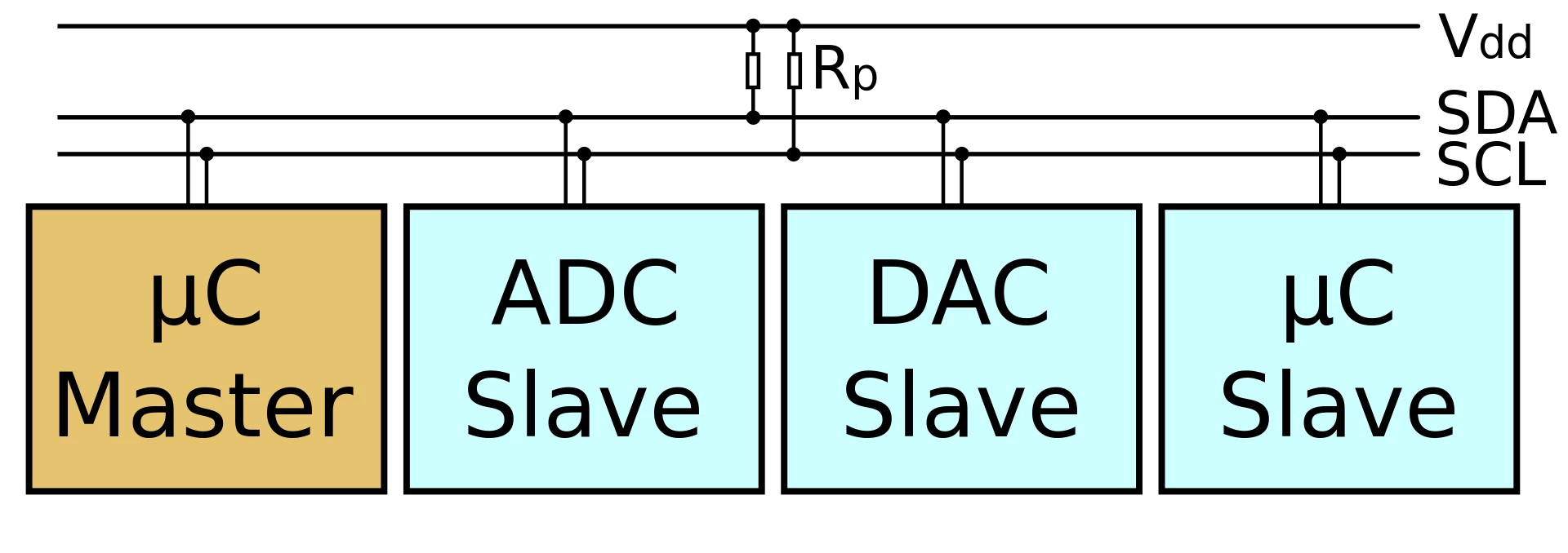

Andrew Neil
Jul 6, 2021 1:05 PM UTC
As @LMI2​ said, I2C is a bus - the whole point of a bus is that multiple devices can share it. That's why it has addresses.
You don't need a separate I2C for each peripheral:
0693W00000BcwrDQAR.pnghttps://en.wikipedia.org/wiki/I%C2%B2C
