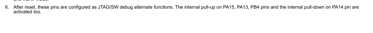

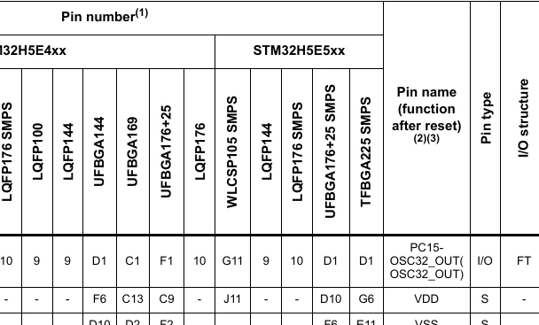

is given in ds , as always.

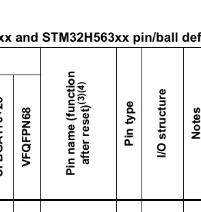

see here as example: H5 , pin/ball definition
Pin name (function after reset) - is given in every ds for every cpu .
 + important: read the notes…. here from H563 :

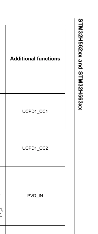

On some cpu/SOC there are even functions, that are always active/working, even under reset !
  • Additional functions - here in H563 pin definition : the pins for usb PD , always active (pullup/down resistors...etc),
