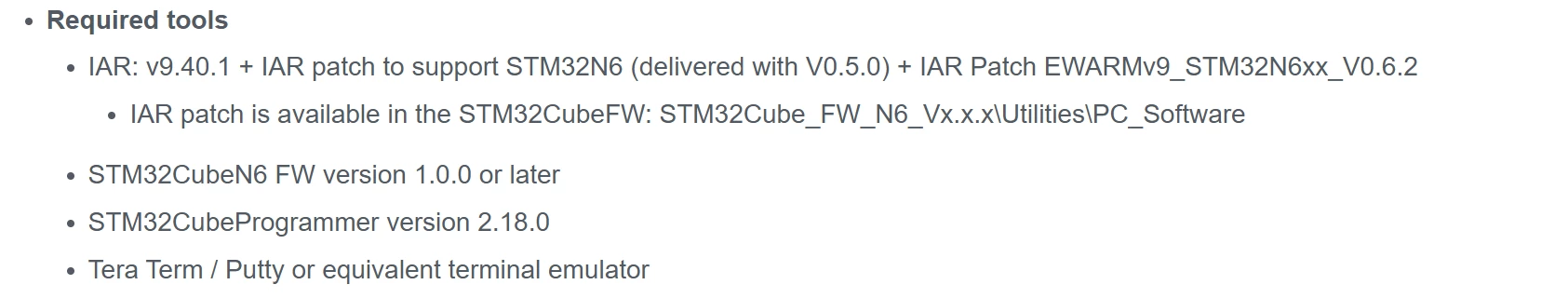

MM..1
Aug 12, 2026 8:36 AM UTC
Sorry, but we normal for start require one A4 … Plus one absurd example from your last link wiki
Required IAR ??? Are you sure?
