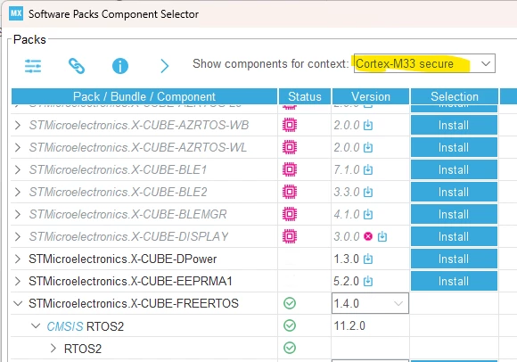

December 3, 2025
Hi
I had a similar issue.
  • In Cube MX, Pinout and Configuration->Software Packs->Select Components
  • Change "Show Components for Context" to Secure
  • Add the package X-CUBE-FREERTOS
  • Click OK
    Note this is for secureNote this is for secure
  • Now Select X-CUBE-FREERTOS under Middleware and Software Packs. I select CMSIS RTOS v2 (as I need the portable API)
Have you had success using it?
