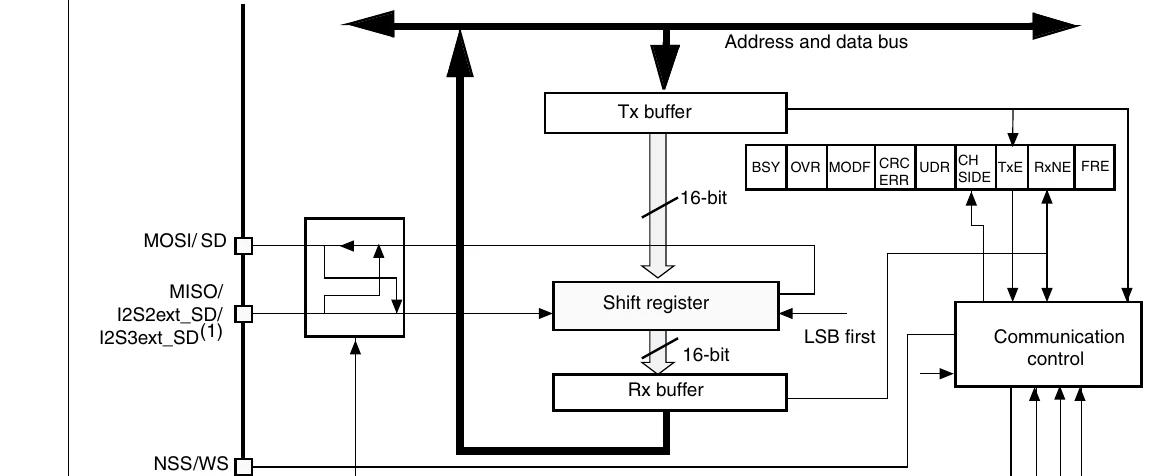

I am in desperate need of your help. I am trying to extract audio from an INMP441 microphone using a Nucleo STM32F4RE11 and store it as a WAV file on an SD card. According to the datasheet, the microphone outputs signed PCM 24-bit audio in MSB-first order, wrapped in a 32-bit frame.
To handle this, I have configured the I²S "Data and Frame Format" to "32 Bits Data on 32 Bits Frame", attempting to extract the 24-bit data from the 32-bit frame and convert it to Little Endian format. However, I am facing issues with the extracted audio:
  • While I can recognize my voice's timbre, the amplitude is extremely low, and the waveform appears very weak.
  • When I previously tested "16 Bits Data on 32 Bits Frame", my voice sounded unnaturally deep, almost like a male voice.
I suspect there may be an issue with my bit extraction or size allocation. Here's a brief summary of my setup:
  1. I declared an int32_t variable to store the raw I²S data and used the following function to record audio:
    HAL_I2S_Receive_DMA(&hi2s3, (int32_t *)data_i2s, sizeof(data_i2s)/4);
    However, I am concerned that this might be incorrect since the function prototype expects a uint16_t * pointer. Given that I’m handling int32_t data, I’m unsure of the correct way to manage this typecast.
  2. For extracting the 24-bit data, I have performed bit-shifting and swap the bytes to store in Little Endian format, but I’m not sure that I’ve done it correctly because the extracted audio I got is so low.
I have attached screenshots and code snippets for better context. I would greatly appreciate any insights on how to debug this issue.
Thank you so much!

The I2S should be set : master receive , 24b in 32b frame . And use the SAI in I2S mode , much better than I2S.

SO on F411 now - this has no SAI.
And on 32b frames i had some problems onmy tests with F411, i concluded: here 32b mode never working  as it should - but seems, no problem, almost not used by users.
So i tried the SAI on H743 (or other from H7 series) and using it on I2S mode works perfect, also on 32b data or 24 in 32b frame.
For your INM... mic : it has 24b data, so you have to use : I2S master receive , 24b in 32b frame.
Can you set this on F411 ? (i cannot try now, i am at work...)

Right, to work with 24b data, its obvious to store 32b , int32_t .
So your data is just a int32 , no shifting together needed.
But we have some problems here:
- the spi/i2s on F411 can handle only 16b in its shifter :
- (it might not work correct...at least: i didnt get it working always (!) correct with 32b data )
- set I2S to 24b in 32b frame
- set frequency --- or not ? is this slave/receive or master/receive ?
from ds: mic is slave, so I2S set to: master receive , 44k or 48k , or what you want ?
- you have to set the dma matching this : (not sure its needed --- just try)
- (if HAL really cannot handle word transfer, try setting : half word + half word)
set in CubeMx -> project -> callbacks for I2S ;
then use half/full callbacks to get the data blocks (mabe 2x 1K , 1024 int32 in every block) and move the data to your receive buffer; I2S stream has to be continuous, so just start the stream at program init, then use the data or just skip using, but never stop/start stream. Just use data , in callbacks, or not. Thats it - then it should work fine (if i2s working correct and dma settings ok. )

Thank you very much for your insight! I've actually just saved myself by checking the bits and finally it was wrong because I only used mono channel but I didn't throw away all the right-channel bits which caused the damage to the audio. I am experimenting with SAI right now and may I ask if using 3 I2S peripheral (for 3 INMP441 PCM mics) and 1 SAI (4 PDM mics in TDM mode) possible? I want to be able to use as many mics as possible for better calculation resolution so I'm thinking of purchasing an STM32H7 board to be able to use more mics and more calculating power.
