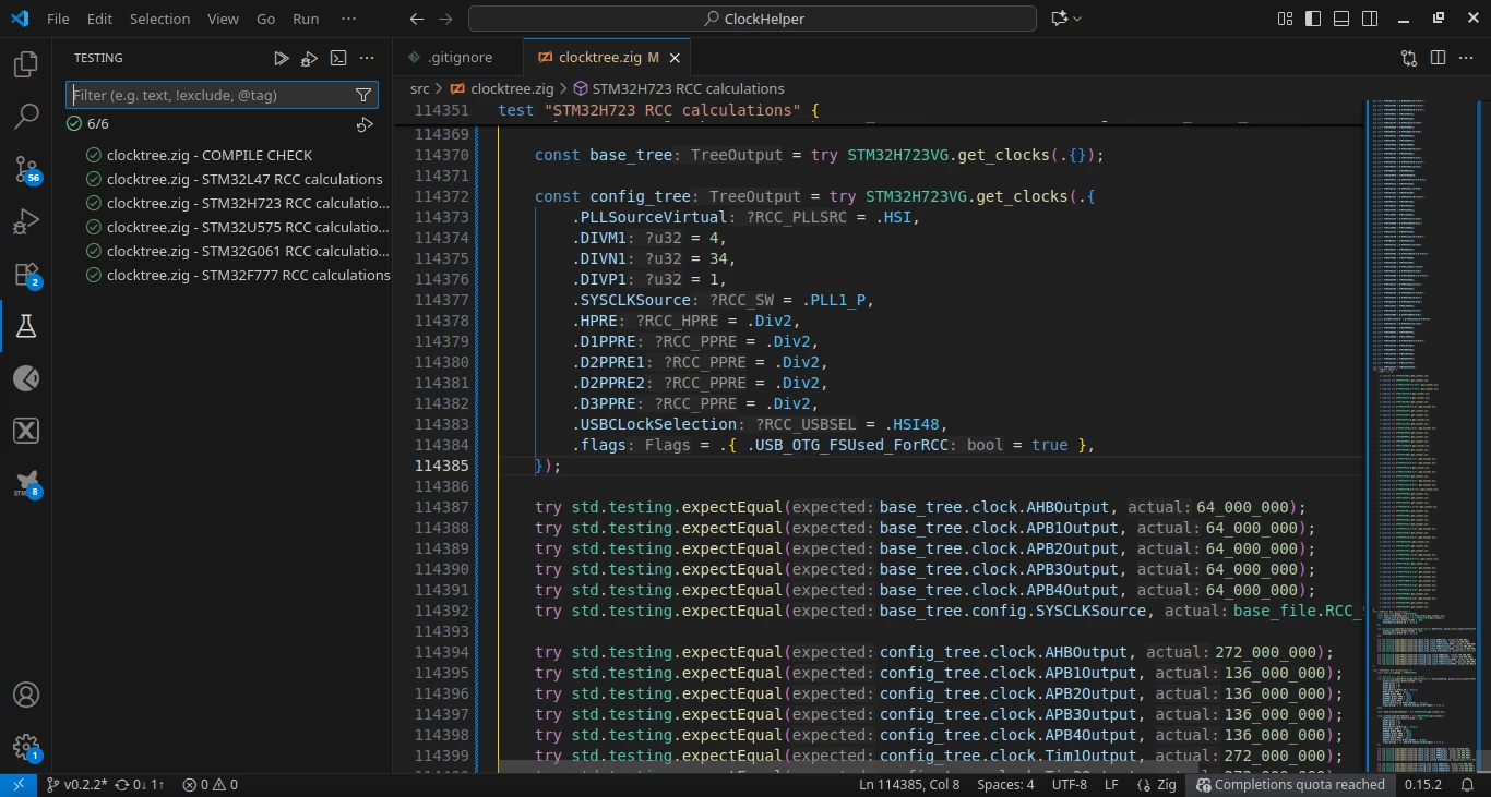

One of the first tests was validating clock calculation and verification across multiple domains.
Starting with the “happy path”, using a valid configuration — just checking that all computed values match expectations:
Nothing too surprising here: the calculations are correct, everything behaves as expected.

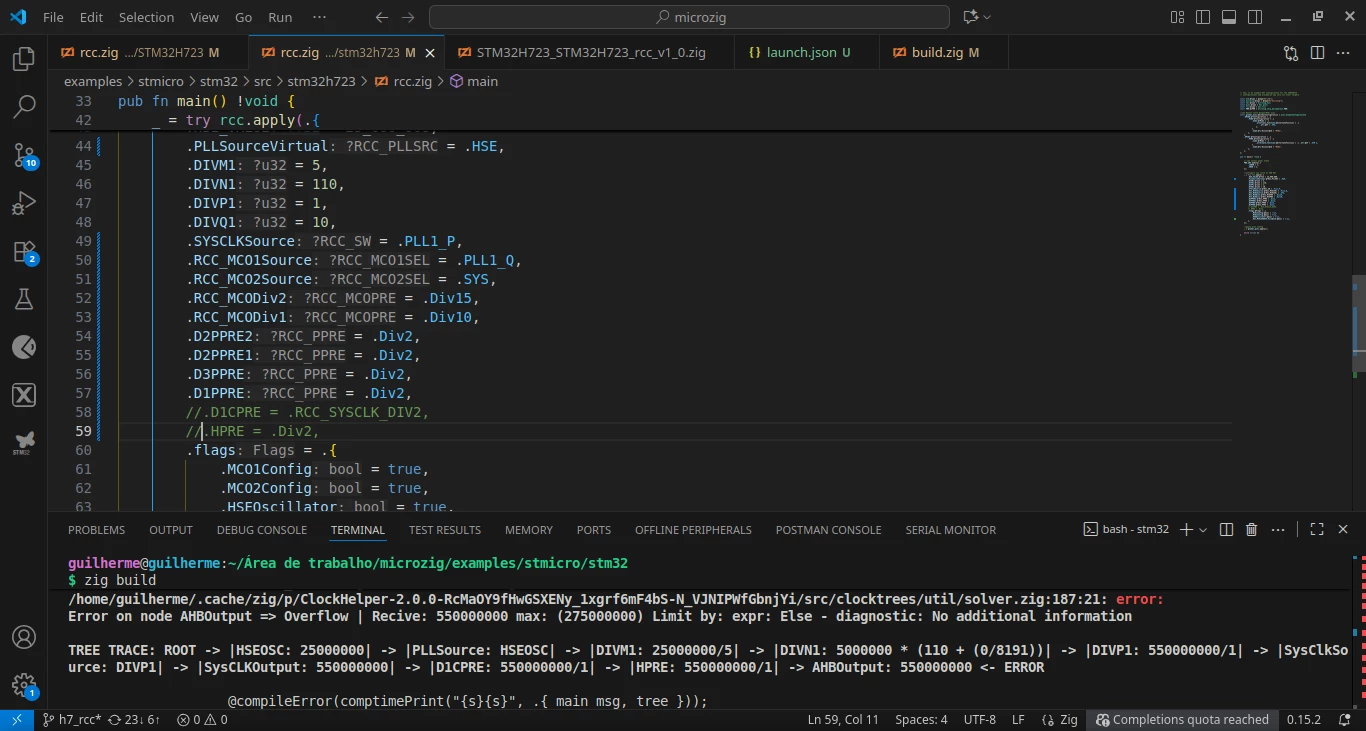

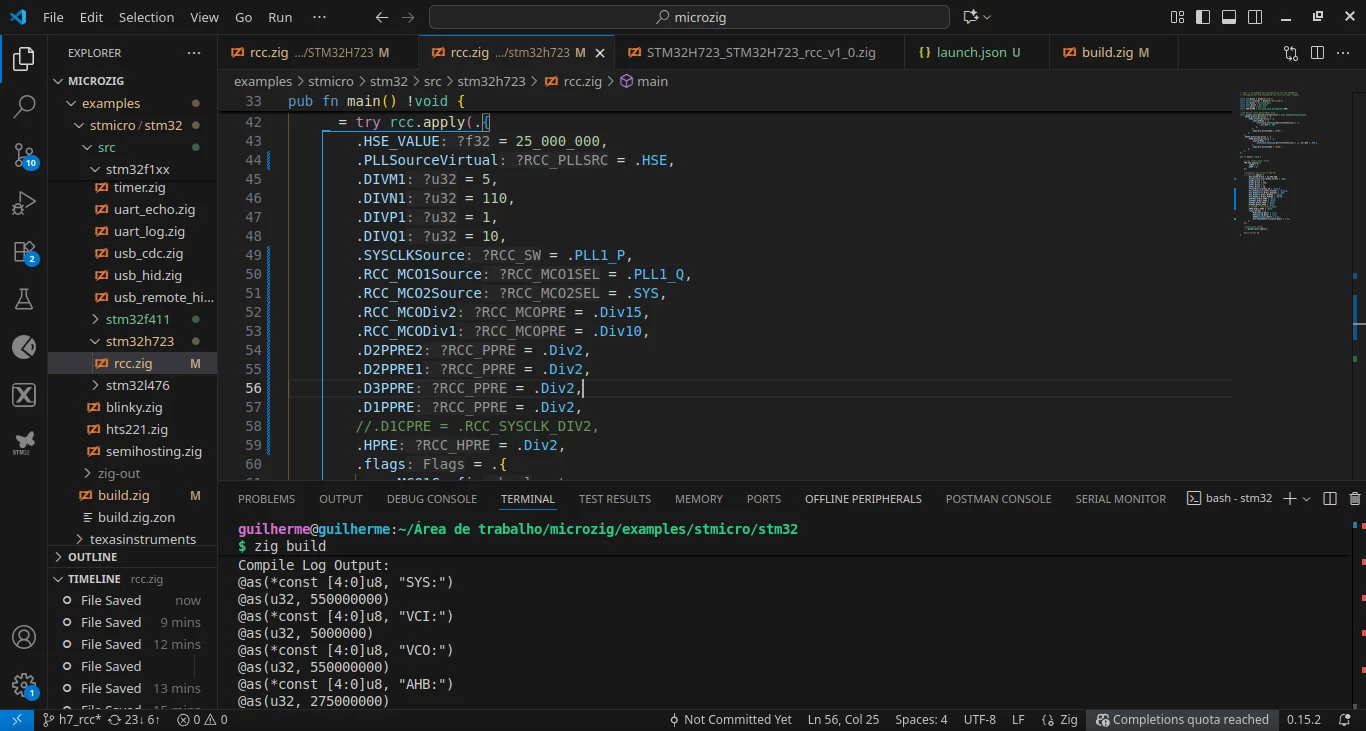

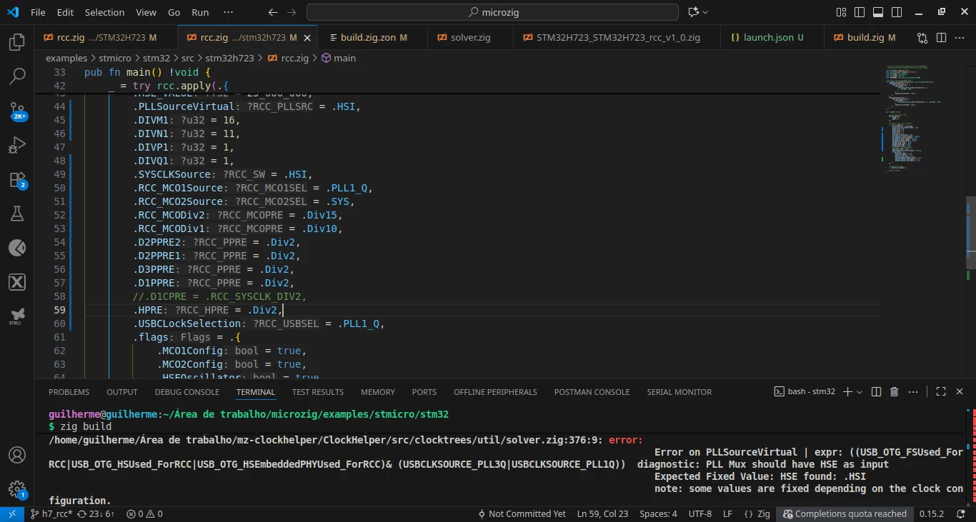

For example, taking a configuration targeting ~550 MHz on the STM32H723:
Everything looks fine — now let’s start breaking it on purpose:
Removing the AHB prescaler (HPRE) causes the frequency to exceed the allowed limit:
Enabling USB and selecting the PLL as its source, but not using HSE as the PLL input:
In this case, the validation ensures that when the PLL is used as the USB clock source, its input must be derived from HSE — otherwise the configuration is considered invalid.

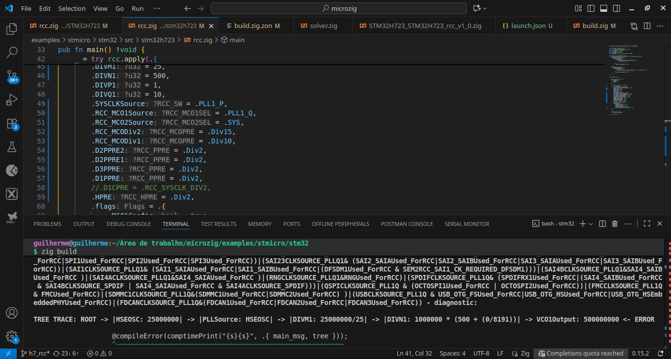

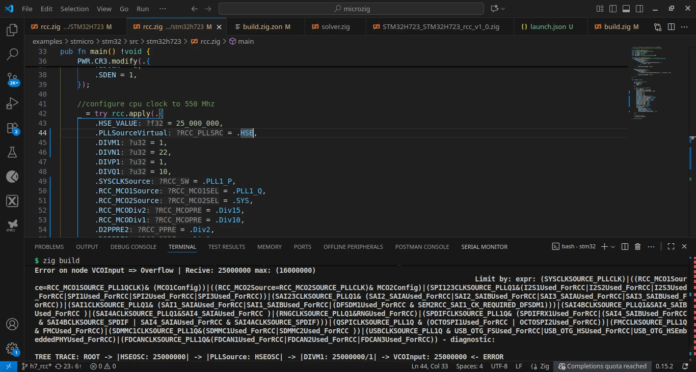

Another interesting case is the relationship between VCI (PLL input) and VCO:
By adjusting the input divider (M), it’s possible to push the VCI out of its valid range, which in turn invalidates the VCO — even if the final frequency might look correct at first glance:
This kind of issue is particularly tricky to catch manually, since it involves multiple stages of the PLL at once.

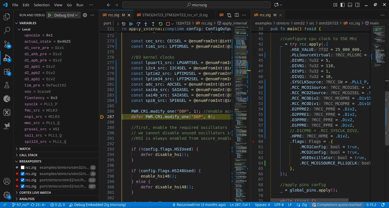

Finally, even parameters that are not explicitly configured — such as VCI/VCO ranges, VOS, and flash latency — are automatically derived based on the current clock configuration.
The idea is that once the clock is defined, the rest of the system adjusts itself to remain within valid operating limits, without requiring manual tuning of every parameter.
In addition, by using data from the embassy / stm32-data project, most of the generated values are bit-accurate with the hardware, making the setup essentially plug-and-play when applied to registers.
