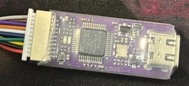

and the debugger https://github.com/WeActStudio/WeActStudio.MiniDebugger.

3- What kind of hardware tool you are using to connect to the board? STLINK? Could you please take a picture of your probe and share it with us?

3) Yes, STLink is probably modified with the original ST chip.
If the problem is with the cable, I don't think it's a problem because when I tried it with the same debugger and cable with the same chip but on a different board, it worked.
