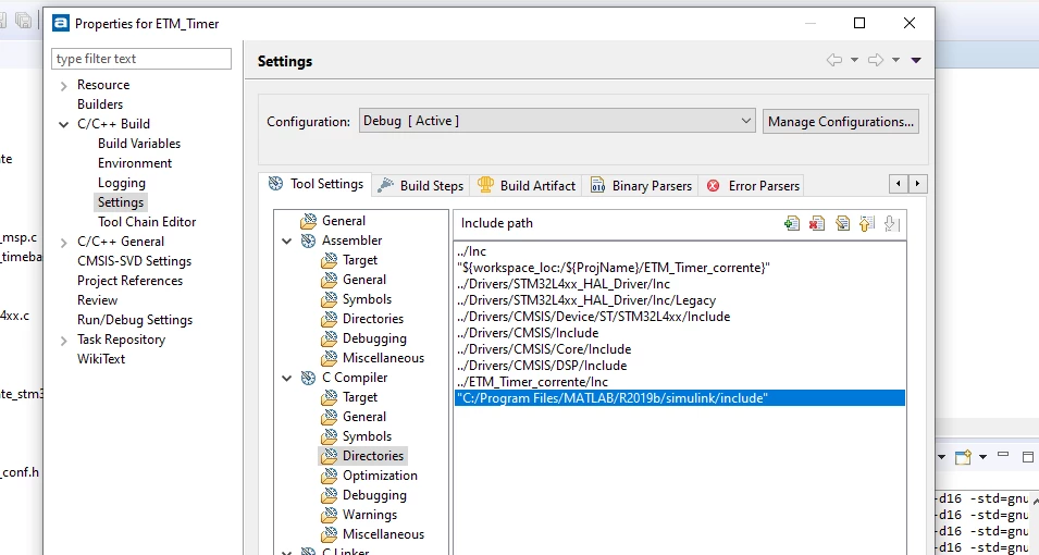

ERROR arm-atollic-eabi-gcc: error: Files/MATLAB/R2020a/simulink/include: No such file or directory WITH STM32MATTarget_5.6.0
Hello everybody,
I installed version 5.6.0 of STM32MatTarget and tried to use it by generating a code for a simulink simple blink LED project.
I made the configurations as per the guide, but when I start the project on Atollic or CubeIDE I get the same result:
With version 5.4.0 this did not happen.
Anyone have the same problem? I use the version of matlab / simulink 2020
Thank you and good evening

Hi @MMira.2​ ,
You are facing a problem with an include path that contains spaces in it.
This is a known issue of project generation by the STM32CubeMX tool for Eclipse based IDEs.
Simply surround this path with " and it should work.
Sorry for the disturbance.
Regards.

0693W000000Vvp8QAC.pngThanks Cyril,
This is the correct configuration in order to resolve de problem.

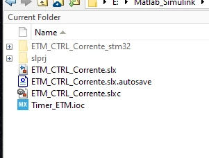

MMira.2
MMira.2Author
Apr 16, 2020 11:14 AM UTC
Now the Build Command in Simulink Model not generate all project file. Anyone have the same problem? This problem is present both Matlab 2019b 2020a
