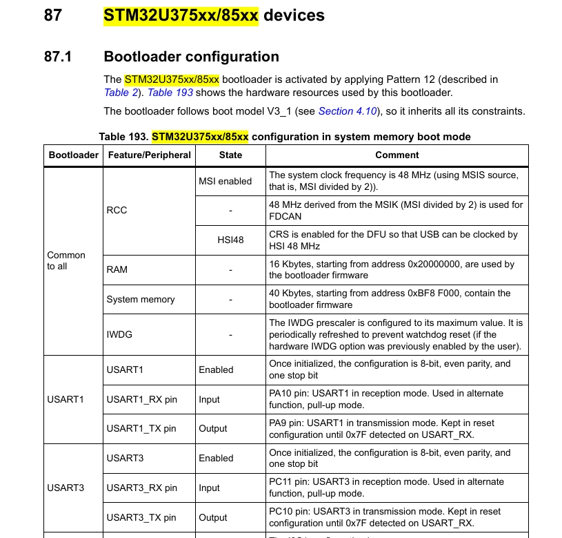

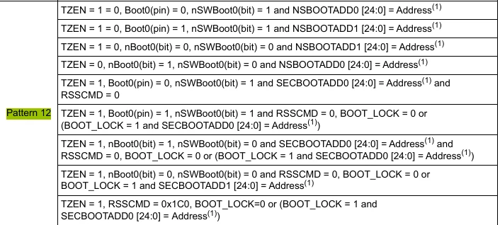

usart.PNGpattern 12.PNGHello @mƎALLEm,
Thank you for your response.
I read the AN2606 document, which explains the USART configuration and the bootloader settings.
Normally, to flash a .hex or .bin file, we need to boot from the System Memory using the BOOT pins. However, I want to boot(system boot) my ST controller using from my application code, without using the hardware BOOT pins. In other words, I want to trigger the bootloader by software instead of configuring the BOOT pins physically.
Note - I am not using STM programmer utility or any STM utility
Thanks,
Vrushabh Kale

mƎALLEmBest answer
Dec 9, 2025 10:39 AM UTC
@Vrushabh_1157 wrote:
Hello @mƎALLEm,
However, I want to enter the system bootloader from my application code, without using the hardware BOOT pins.
Please refer to this knowledge base: How to jump to system bootloader from application code on STM32 microcontrollers
