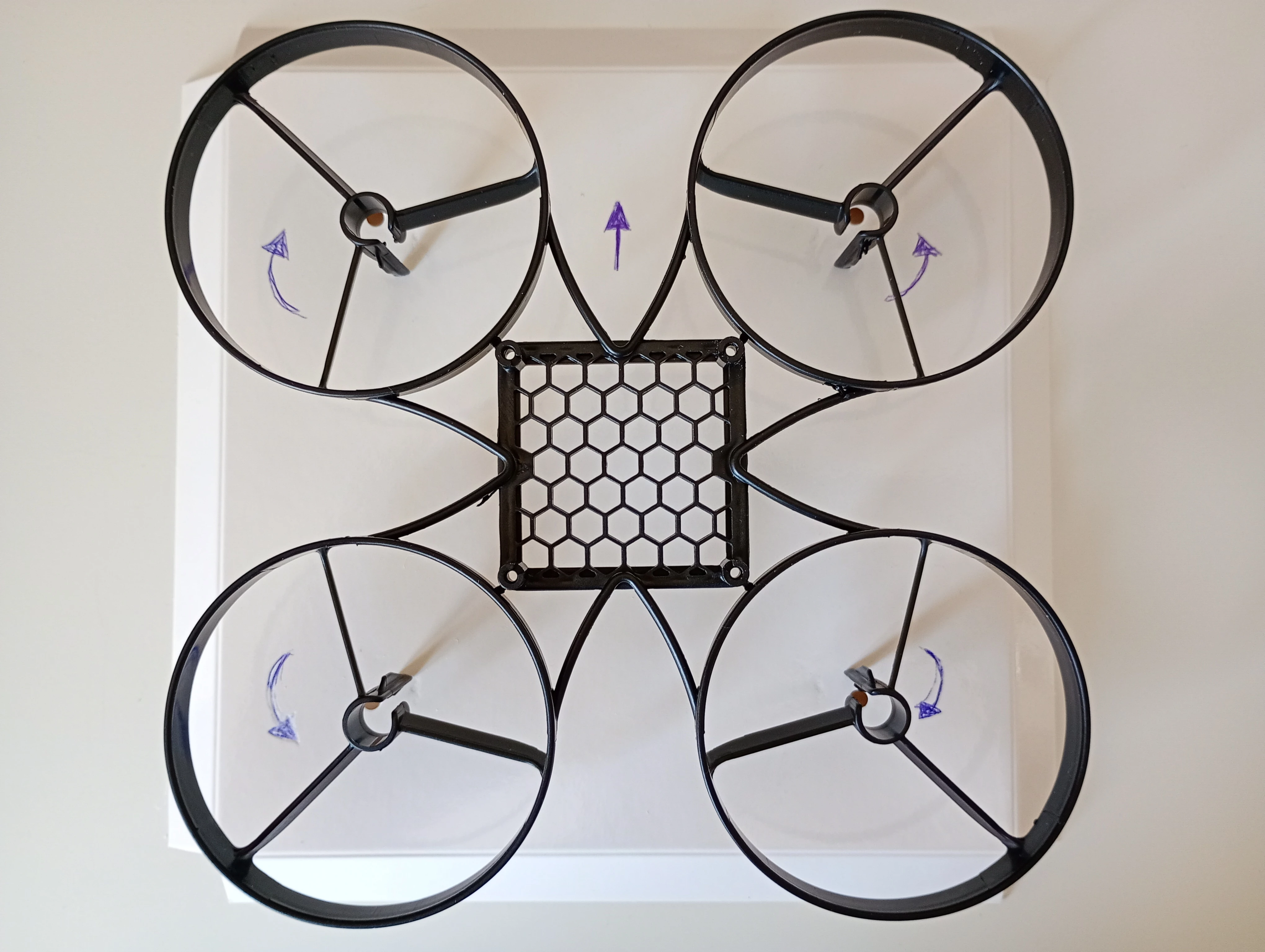

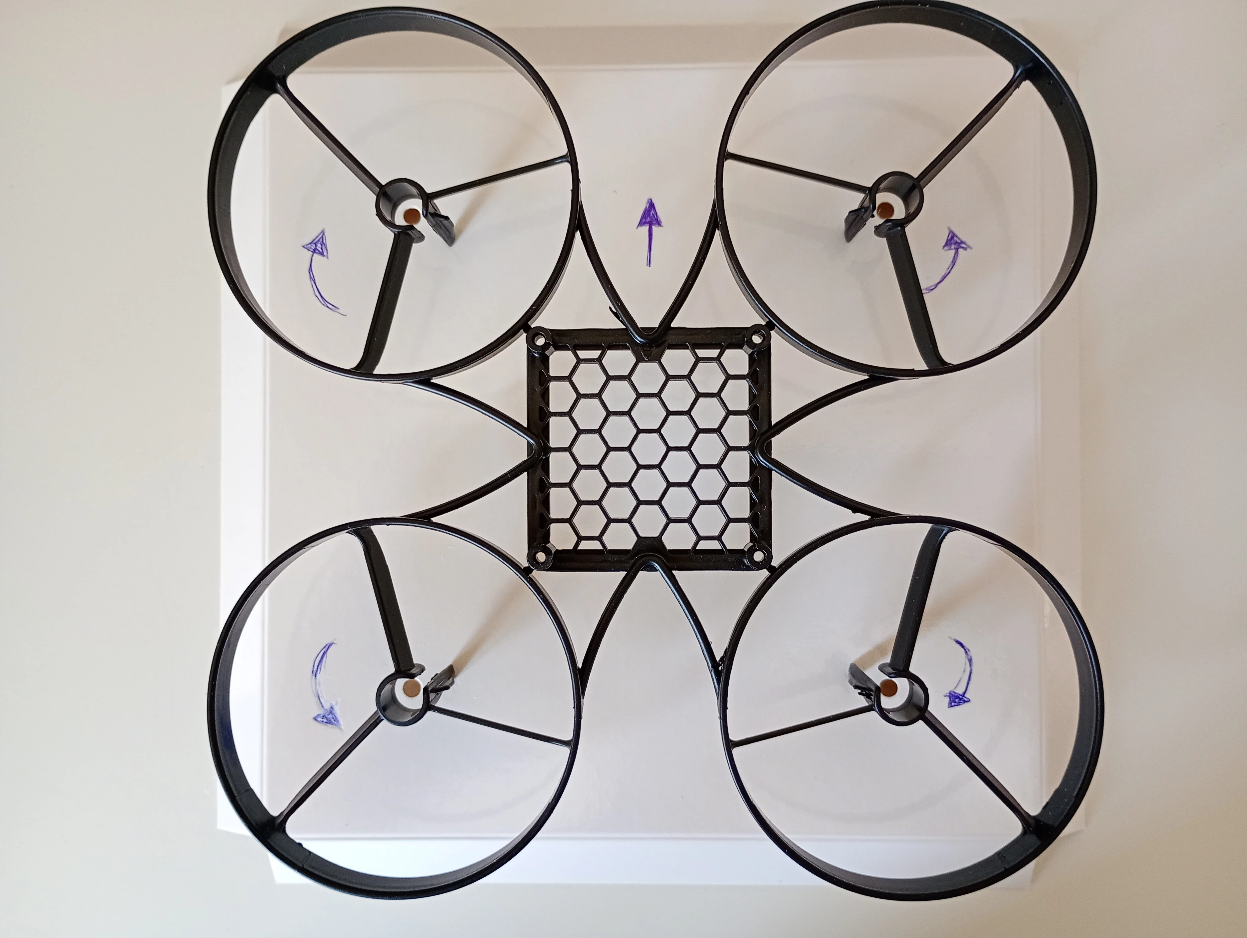

As mentioned in the other post that the drone frame is not symmetrical, where the propeller guards have fins with certain inclination and orientation (see [1]).
I have difficultly to find the correct orientation of the drone02 frame. Since I am not quite sure how the propeller guards fins can affect the downward thrust that produces by the propellers. It would be great if someone can provide suggestion.
I enclosed two cases of the drone frame orientations as reference.

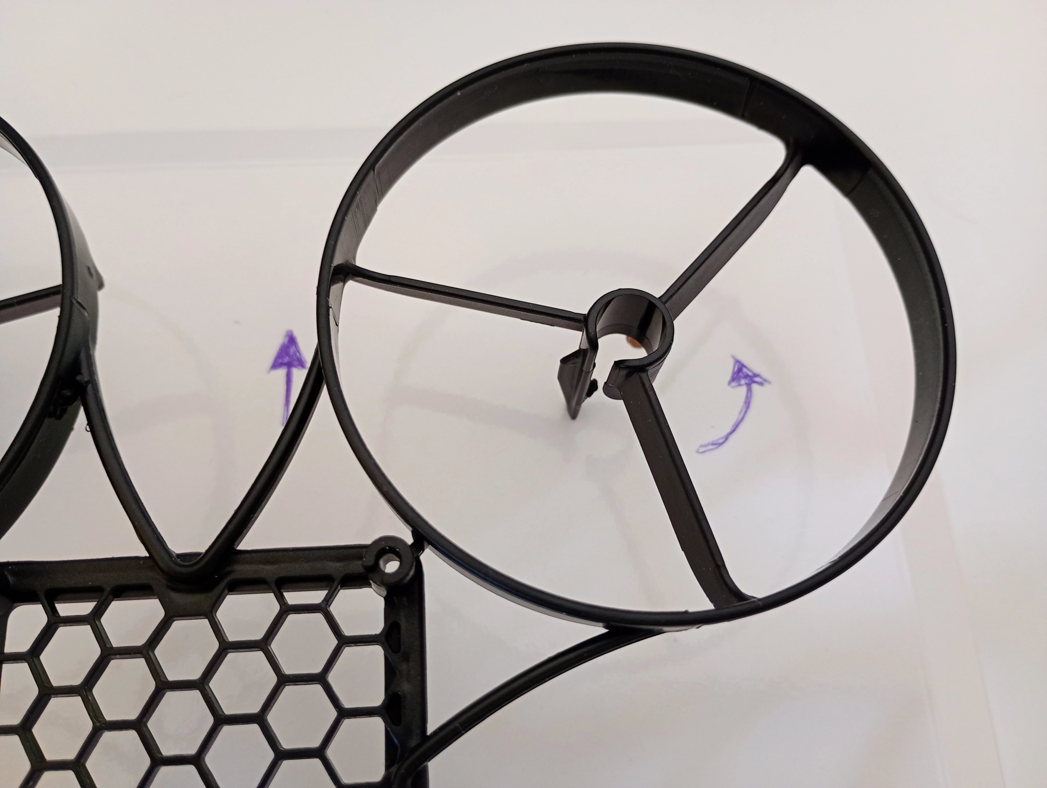

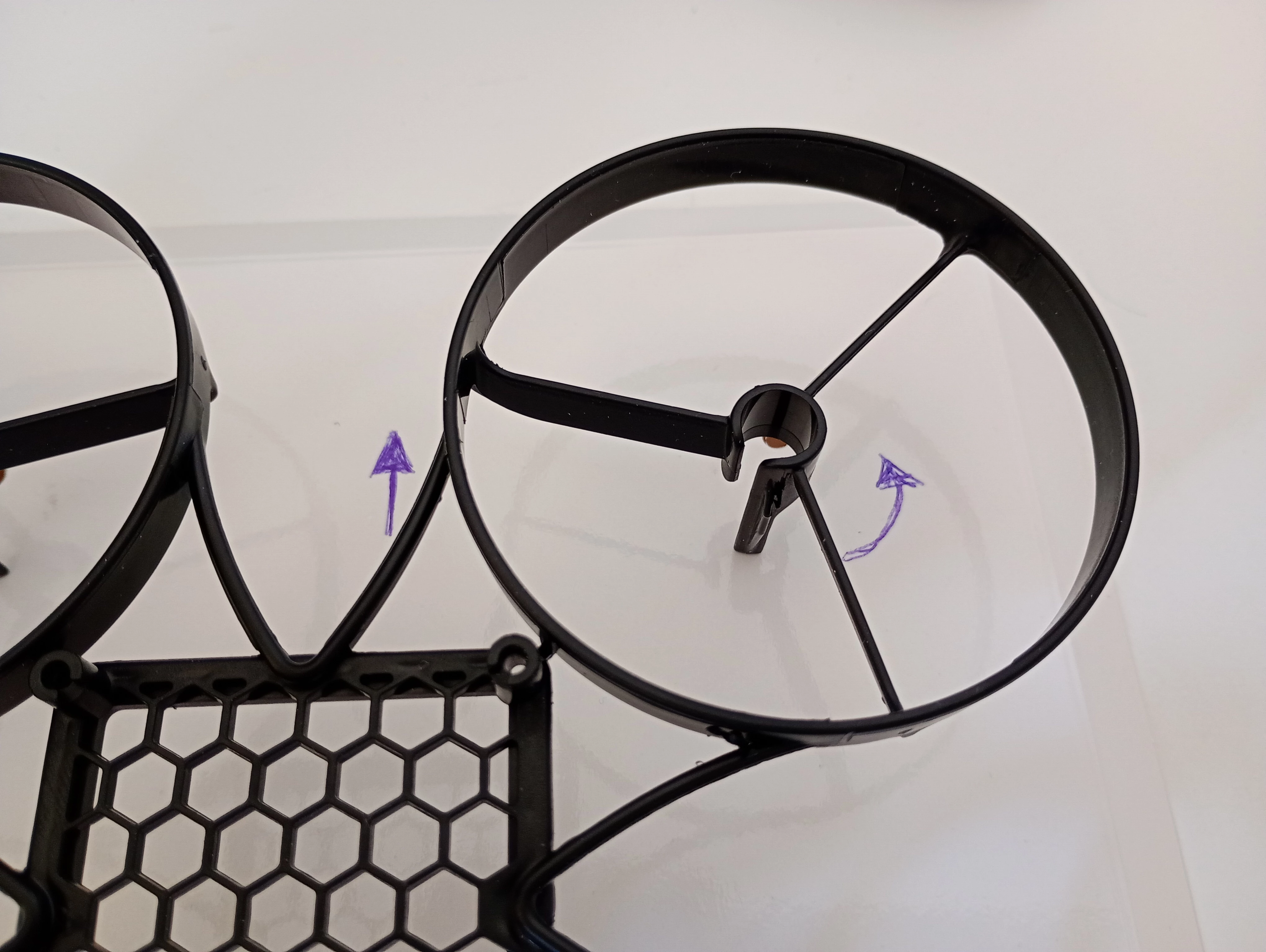

NOTE: If I use Figure8 in [2] as reference, then Case1 does look correct. But taking the M2 propeller (top right of the propeller) as an example, the M2 propeller rotates counter-clockwise (CCW) direction, then I think the produced thrust will hit the guard fins and get affected?
Case 1
Case 2
Case 1: top right (for M2 motor/propeller)
Case 2: top right (for M2 motor/propeller)
