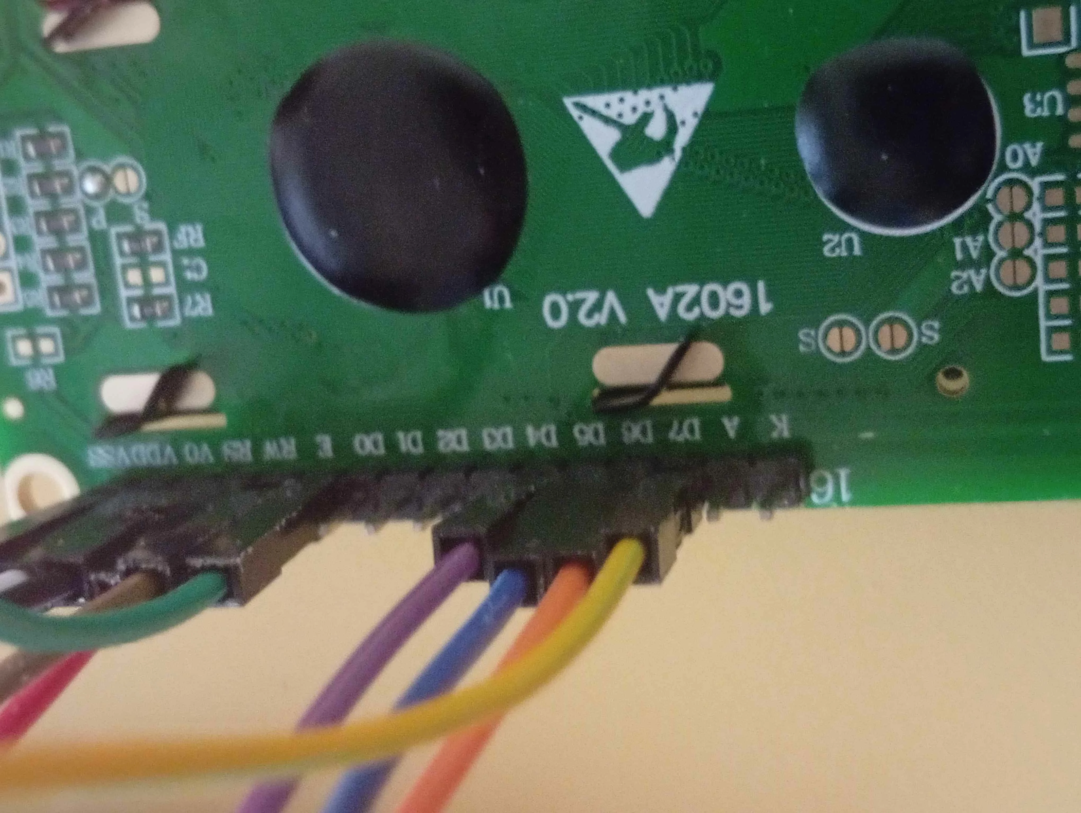

Connection to alphanumeric LCD model 1602

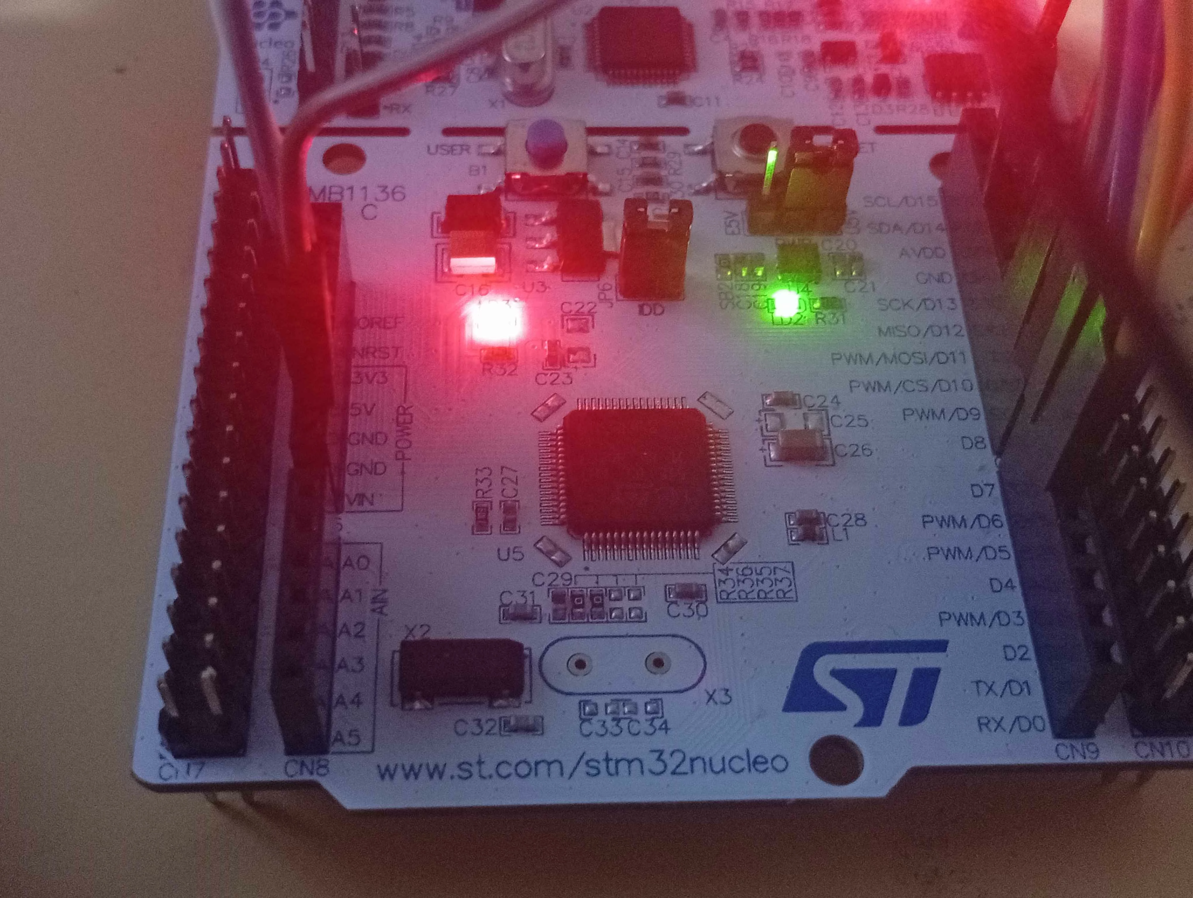

Hello. I am a beginner, I am trying to connect an STM32 nucleo f446re to an LCD, model 1602A V 2.0.
I tried making a test code with no functions to see if the display works

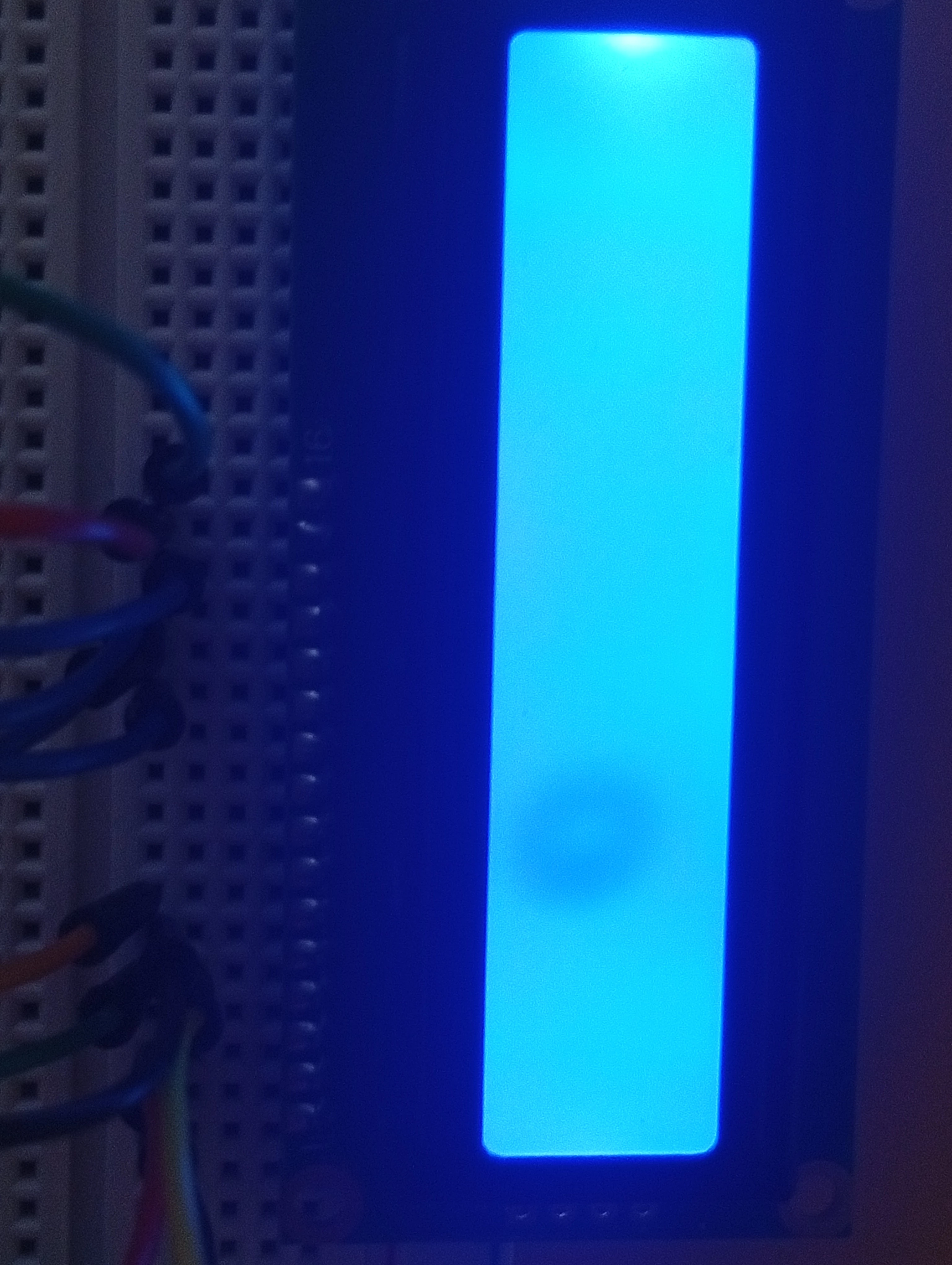

I only see a grid of rectangles light up and when running the code no characters display. What could be the issue?

LCD wiring
STM32 wiring

Hello ​@Rick_ and welcome to the ST community,
That means the LCD is not yet/not correctly initialized.
At this stage avoid the direct access to the registers as it introduces more complexity in the analysis. Use HAL and follow the LCD initialization steps mentioned in the LCD datasheet.

There are a lot of “1602” compatible LCDs from different vendors. We don’t know what exactly you have. Does it require 5V inputs? The STM32 output pins provide 3.3V. If not sure, consider other LCD module which has I2C interface (some of these on Ali express consist of a “1602” + I2C interface board) . Costs slightly more, but much easier to use.
I would definitely second that.
These modules are quite widespread in the Arduino world, and many of the common Arduinos run with 5V.
I would recommend to download and read the datasheet and user manual for the LCD board.

Rick_Author
Sep 10, 2026 8:41 PM UTC
Because I couldn't display characters using the STM32 i tried connecting the LCD to an Arduino for testing.
After turning on the backlights I saw a large black spot on the LCD, which makes me highly suspect that it is defective.
Ozone
Principal
Sep 11, 2026 5:26 AM UTC
Might be a quality issue (substandard, but not necessarily defective), you often get what you pay for.
I would extend the Arduino example to fill the display with characters, and check how this looks like.
