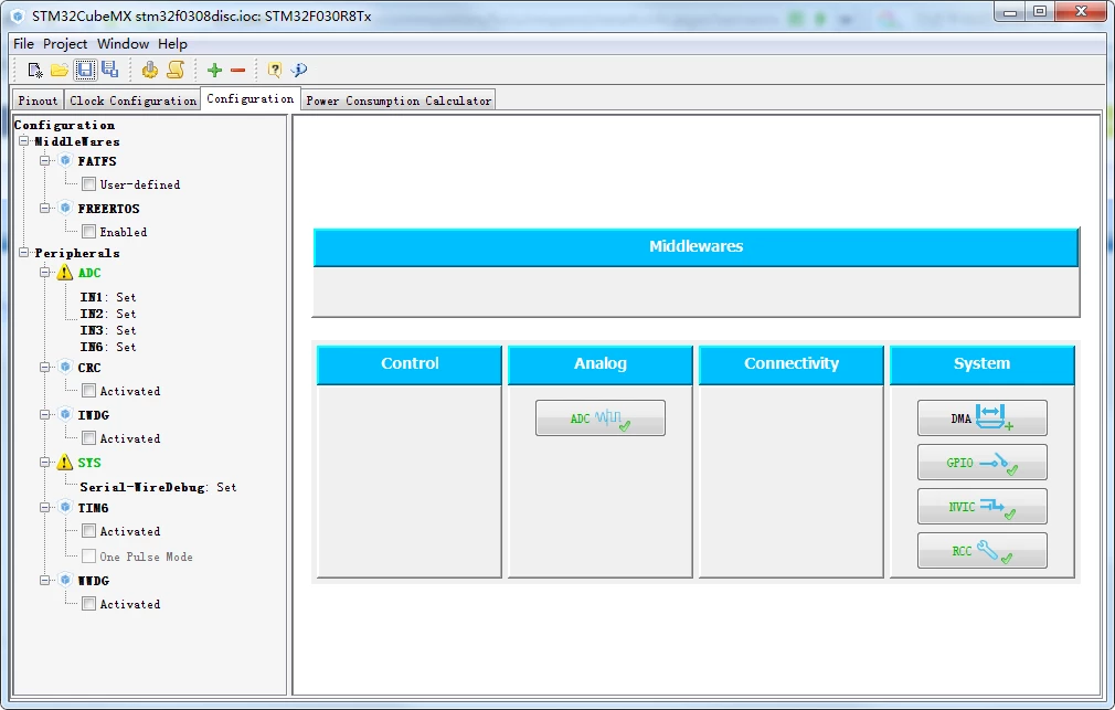

I set a model in simulink and drag a MCU config block in it,then I select the .ioc file which was generated in stm32cubeMX.I chose the stm32f0803 discovery board,and configue the ADC peripheral in stm32cubeMX.
But when I drag the ADC block into the model,the pop-up box appear,which writes ''!!selected ADC has not been configured!!''.but i have configured the ADC in stm32cubeMx.How can i do now?hope for help,TY!
